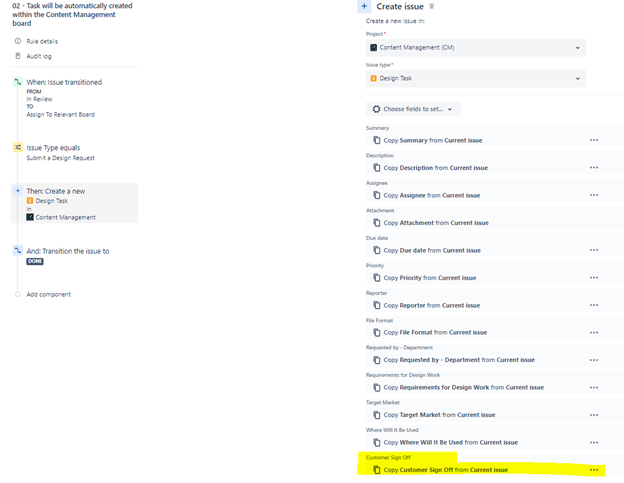

Pic 1 shows the automation rule used and highlighted is the field that is not copying data over

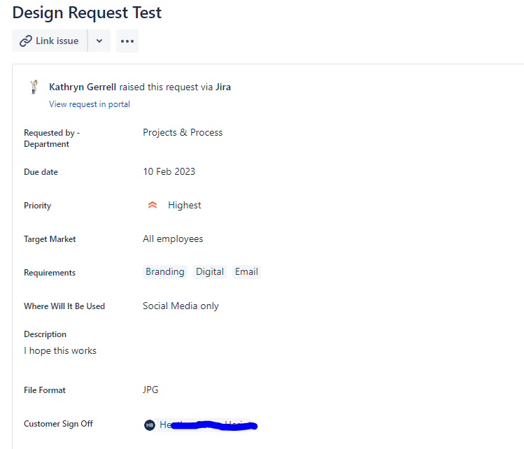

Pic 2 shows Customer Sign Off field populated within Service Management project

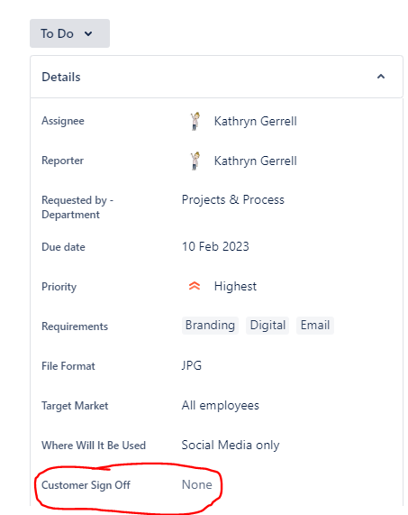

Pic 3 shows Customer Sign Off field not populated within Software project
