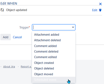

Markus Pöhler
October 14, 2022
Hello @Arnaud Marquis
saw your thread after I was looking for a solution to use the content of fields within object change triggers in insight.
Unfortunately, neither "When: Field value changed" nor "Then: Create variable" exists as options in the automation rules I can define.
What am I missing here?

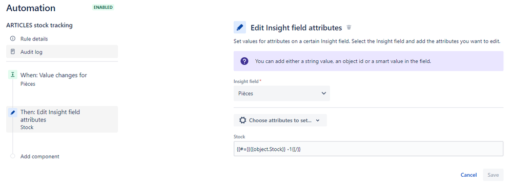

Gaurav
April 26, 2022
This is an interesting use case. I have done something similar previously, but I was mainly extracting the data from the Insight schemas.
Looking at the rule, I think it is not able to point/ gather the exact 'Stock'. So the question is stock for what?
I believe you would have some other Custom Field where you would be storing the item whose stock would need to be depleted. Replace the word 'object' with that field name and try. It should work.
Please find below the screenshot of my implementation. Kindly accept the answer if this helps.
Regards,
GG
Arnaud Marquis
April 26, 2022
@Gaurav thanks for your answer.
So the question is stock for what? - Stock (which is a custom Insight object attribute) of that specific referenced object. As I said, it "works" as it updates the stock value of the Insight object I am after. Just not with the right value.
I believe you would have some other Custom Field where you would be storing the item whose stock would need to be depleted. Replace the word 'object' with that field name and try. - No, there is no additional custom field. Just the attribute.
