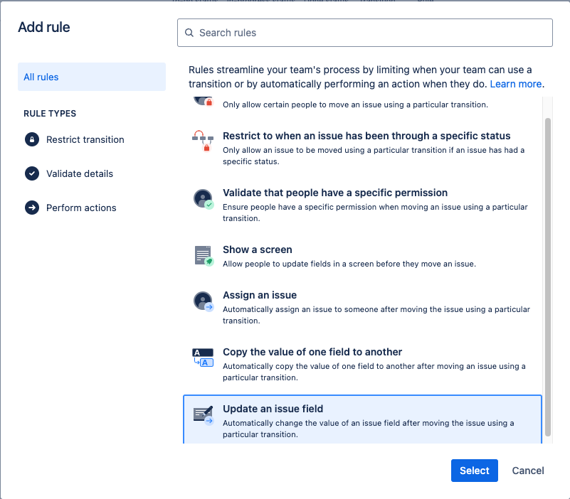

No additional API calls or set ups are need, post functions are a Jira out-of-the-box feature. Here is an example and you can see that one of the options is Update an issue field. That is the rule used to update the resolution field.
Now, there are apps that extends the default rules by adding their own ones, like for example Scriptrunner that allows you to run scripts as part of the rules in the workflow, and that would require you to do more configuration, but normally the out-of-the-box rules should be enough. This KB goes over advanced issue workflow configuration.
