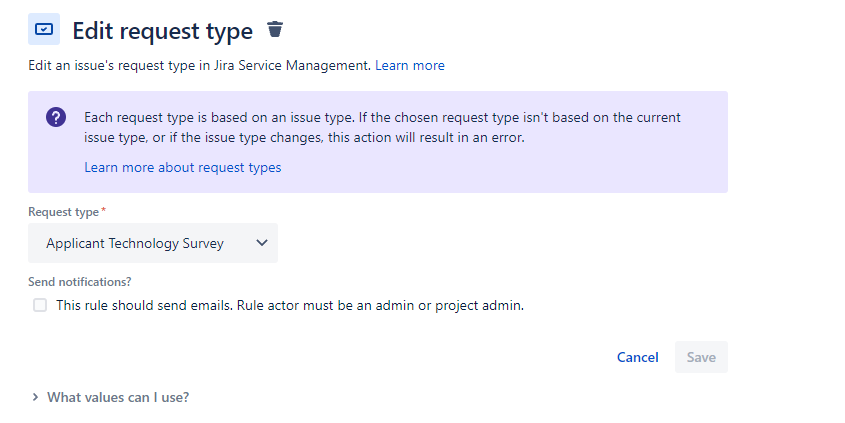

but they are going to the Internal Queue in Jira. We have an automation. that states if you get email from this domain, change request type to internal and move to internal queue

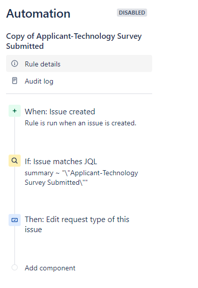

but we have 2 other automations setup that should move the emails to 2 diff queues based on the Summary(subject) Text of the email
it works for all other internal and external senders, just not from this specific sender

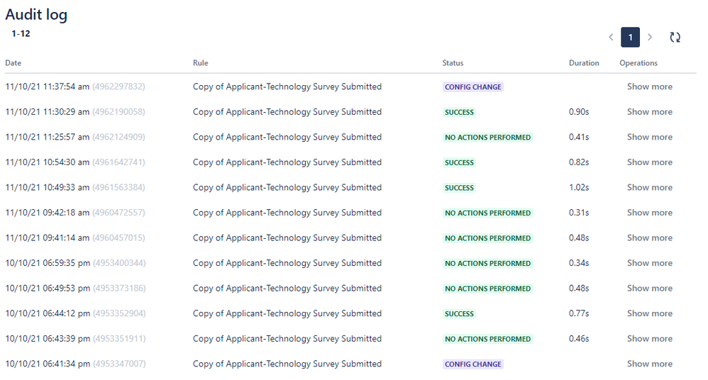

Adam Stierle
October 12, 2021
Adam Stierle
October 12, 2021

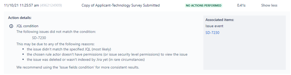

showing it working/not working. here is failure reason

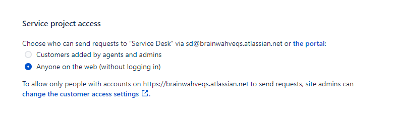

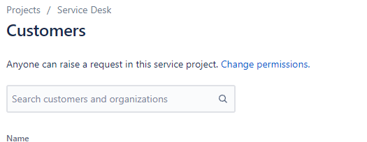

Is this email set up as a customer?
Adam Stierle
October 12, 2021
The Email was not manually added as a Customer
these are our Customers settings
The Emails of the other internal/External users would also be customers by this definition

Can you share your automation? WHat is the trigger? "On Issue Created"? If that's the case, then you need to see your workflow and check what event is being fired from that specific issue type.

Having said that, I see that your rule is getting triggered, but it doesn't pass the first IF statement. The summary/subject of the incoming email doesn't contain the specified text. Can you please confirm that? Keep in mind that specific text might be written with a different encoding, thus the whole IF statement fails.
