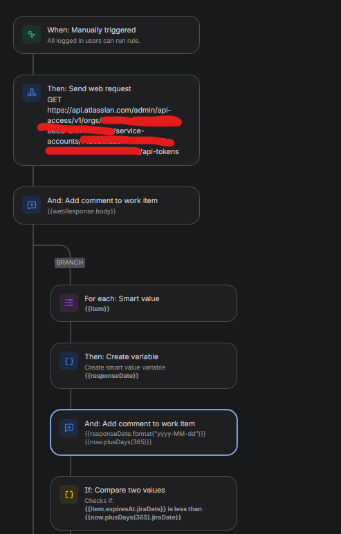

Thanks for your quick response, unfortuanately still getting the same issue.
I've added the variable to the branch as there are multiple tokens it is going through. The variable is returning the value fine, but again, as soon as I try to convert it, it is becomes a blank value.

I didn't get that to work but I stole your idea and got the below to work!
{{item.expiresAt.replace("Z", ".0+0000").toDate.jqlDate}}
Where item = webResponse.body
Thanks for your help! Very annoying that it is all atlassian data but it can't deal with the date format.
