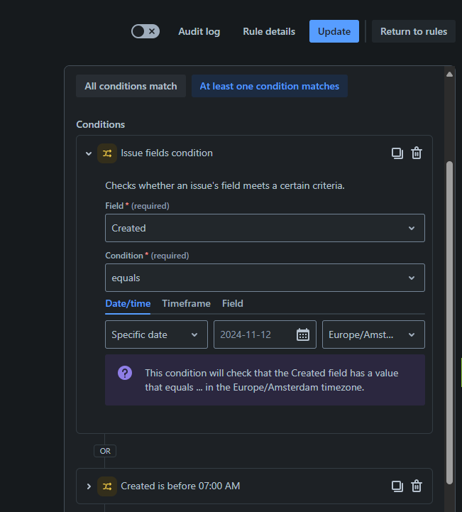

I was asked to create an automation that would only run (auto-assign) every saturday from 17:00 till 23:30. However, I don't see an option or a way to achieve that.
It is either on specific date, or specific timeframe, or specific time in seems. I clicked around on conditions but none seem to fit what I need it to do.
Is it possible? If so, how do I achieve that?

You can schedule an automation rule to run weekly on a specific day, like Saturday, but there isn’t a built-in way to restrict it to a specific time window within that day (17:00 to 23:30). However, you can (to some extent) achieve this by combining a scheduled trigger with conditional checks within the automation.
Set up a schedule trigger to run every hour on Saturdays, (select advanced and type below cron expression
0 17-23 * * 6
This checks every hour on Saturdays between 17:00 and 23:00.
Then add a condition to restrict the time window
{{now.format("HHmm")}}Condition:
is less thanValue:
2330
and the auto-assign action to run within this time window.

Thanks for taking the time to answer. Not sure what your mean by "cron expression", but I figured I will keep it simple and simply make it run on Saturday. Even that is not something I can easily find. Seems like I will have to search up JQL condition of sorts...?
By default it shows you the Basic (where you select days, hours etc). If you select Advanced, you'll see cron expression there
I think I clicked about everywhere to find that Advanced option but really can't see it. Is it available in JSM cloud?
