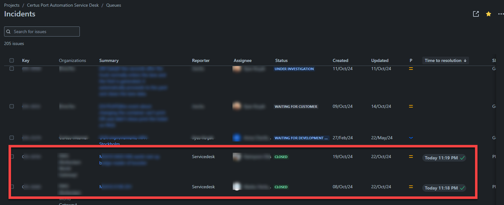

So later on we found out that when a customer presses on Approve, the ticket does close, but it does not disappear from the "Incidents" queue. Just stays there as "Closed".
When we manually press "Resolve" our automation closes the ticket and removes it from the queue. But apparently not if the customer does it.

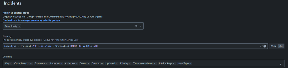

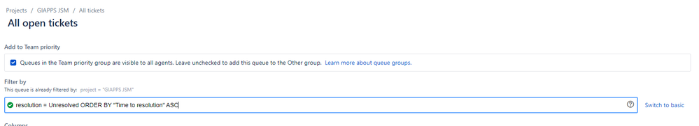

If you're using the default Incident queue, the JQL for it has "unresolved is EMPTY." I think when the ticket gets approved, you're not updating the Resolution field, so that's why the incident isn't getting moved out of the queue. But when you close it, you do set the resolution.
So you have 2 options:
1- Set the resolution field on the approval process.
2- Update the JQL associated to the incident queue
I hope this helps

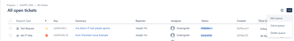

You can update your preferred queue filter query setup. If you are unsure how to access the query, please see the following steps:
1) Access your desired queue and click on "..." symbol and select Edit Queue option.
2) Inside the edit queue UI, switch the Filter by section and click on "Switch to JQL".  So it will display the filter by via the JQL format.
3) Update the JQL to your needs, in your case, and remove the resolution and add the status
i.e statuscategory != Done
4) Save the changes by clicking the Save button to complete the process.
REf: Triage customer requests for your agents with queues
I hope this helps!

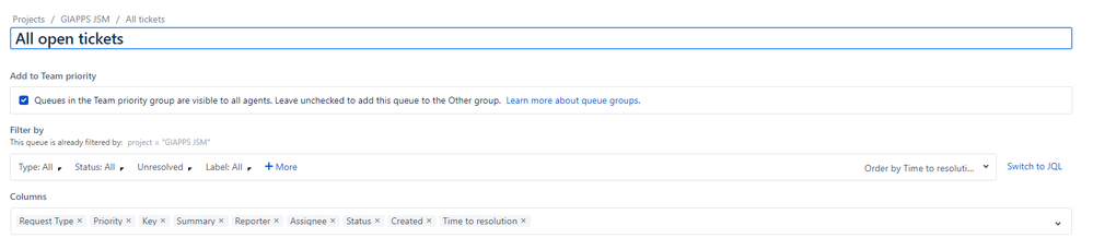

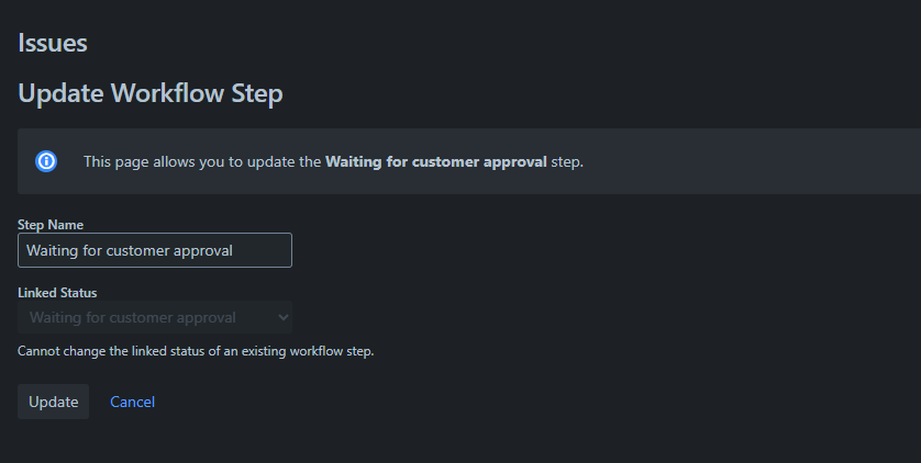

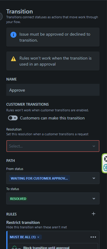

If you look at my screenshots I am kind of stuck hereScreenshot 2024-10-22 163014.pngScreenshot 2024-10-22 163050.png
So when we put the ticket on status "waiting for customer approval" the customer gets an option in their portal with 2 buttons: Approve or Decline.
When Decline is pressed ticket transitions to "Declined.
When Approve is pressed by the customer, the ticket transitions to resolved and then closed but then never goes away from the queue.

Could you please provide a screenshot that includes the following:
1. The JQL in the queue
2. The issue details from a ticket that should be removed from the queue?
Thank you.

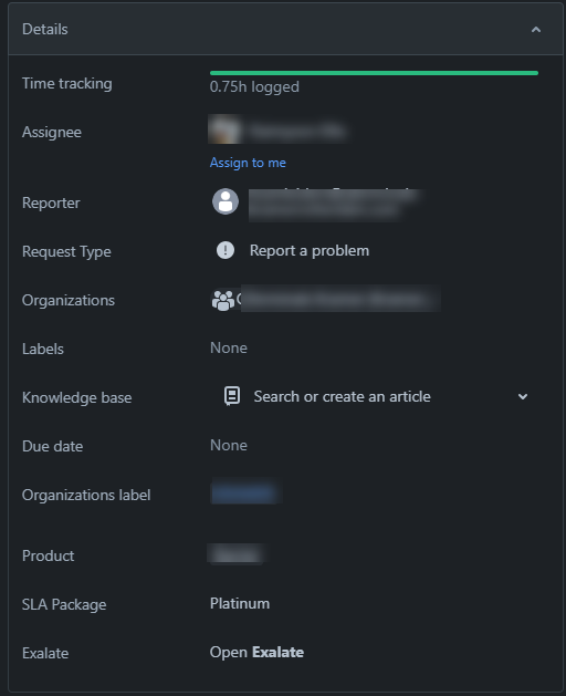

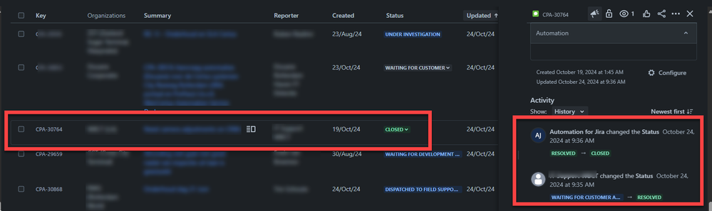

Here is a details pane on the right side of the ticket that should not be in the queue:

Hi @Berik Irgebayev
The image related to the issue is missing the upper section where the status and resolution are displayed. Could you please upload that as well?
Thank you.

Berik Irgebayev
October 22, 2024
I also found this in a new editor:

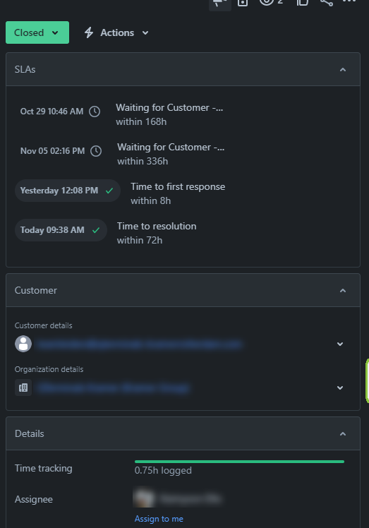

Berik Irgebayev
October 22, 2024
the screenshot you requested:
Samuel Gatica _ServiceRocket_
October 22, 2024
Hi @Berik Irgebayev

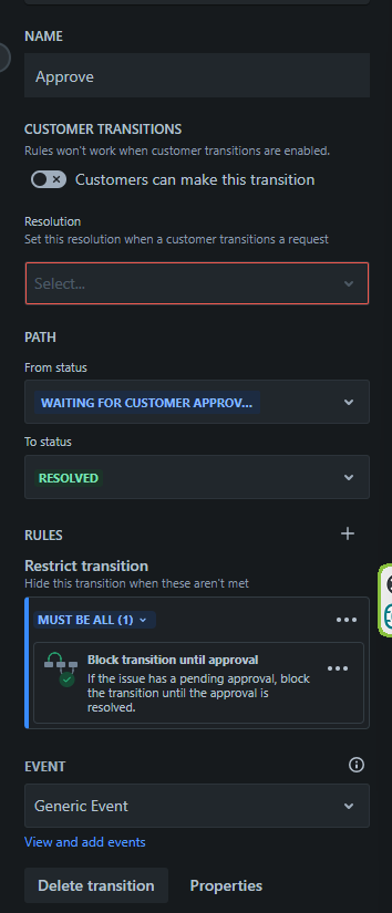

In this section set the resolution and the issue will stop showing in your queue
Best regards
Sam

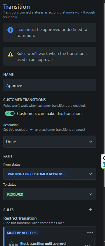

Berik Irgebayev
October 22, 2024
In order to put in a resolution here, i would have to turn on "Customer can make this transition". I'm not sure what the impact of that is. I wouldn't want to screw up the customer portal, they should still only be able to see Approve or Decline buttons.
Do you know if this will change anything else?
October 22, 2024
No, just update the resolution. You don't need to make this transition visible to the customers.
The resolution will automatically update on the background after the user approves the request from the portal.
Berik Irgebayev
October 22, 2024
ok, i did it and will see how it goes the coming days. Thanks @Samuel Gatica _ServiceRocket_
Berik Irgebayev
October 22, 2024
hi @Samuel Gatica _ServiceRocket_ ,
It didn't make any difference it seems (unless changes like that take some time).
As you can see it is still in the queue of incidents while the following adjustment was made:
October 22, 2024
Hi @Berik Irgebayev
You updated the resolution when the status was transitioned from waiting for customer approval to resolved. But un the image you sent the status is closed.
Chek if those issue were moved to resolved before the update was made.
Berik Irgebayev
October 24, 2024
Hi @Samuel Gatica _ServiceRocket_ ,
I just checked the latest tickets that are in the queue right now or were changed as resolved by the customer. Automation then changed it to closed...And it also stayed in the queue as closed instead of disappearing:
Not sure if I should have changed the above screen to Closed instead of resolved?

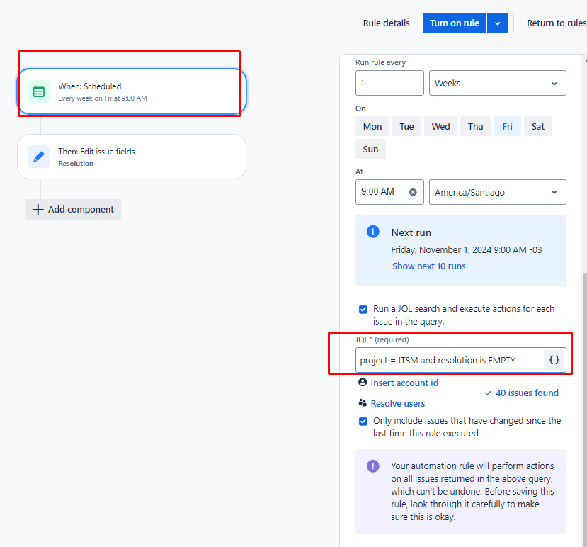

October 25, 2024
Hi @Berik Irgebayev
Please consider adding the resolution field to the automation. You may add this when the ticket transitions to either the Resolved or Closed status.
You can update the resolution for all issues currently marked as Unresolved with Automation.

We basically already have an automation, that when you transition the ticket to "Resolved"  - a prompt pops up with a list of standard resolutions - you pick one and then the automation transitions the ticket to closed. The ticket then disappears from that same queue of all incidents/Service requests.
However, when a customer transitions the ticket in their portal - the ticket also automatically transitions to Closed. But stays in our queue as Closed. It does not disappear. So I have checked it and (see above screenshots) set the resolution to a default one (Done) and turned on that customers can transition too. So I am not sure if I need to be creating another Automation rule. Because it works fine when we do it on our end, just not on customer end, because it waits for the customer approval before going further.
