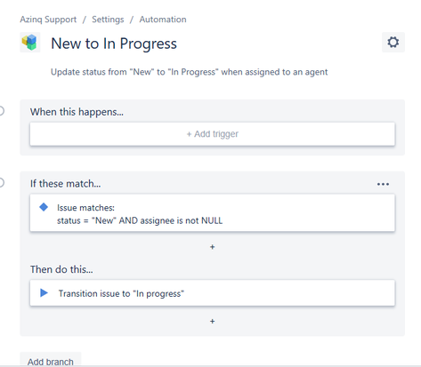

Hi,
I'm new to Automation so I'm looking for some help.
The workflow I am using means that when a new incident comes into the service desk it has a status of 'new'. What I want to happen, is that when the incident is assigned I want it to automatically transition to 'In Progress'. I think I have the rule correct apart from the initial 'when this happens' part of the rule. I'm struggling because I'm restricted to what I can use. I've tried simply using 'issue created' but it failed and I understand why.
Please help!

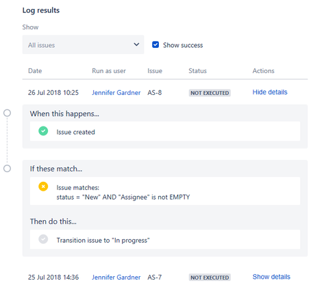

Hi,
Apologies in the delayed response.
I've tried this again by creating a new incident and I get the same result.
Jobin Kuruvilla [Adaptavist]
July 26, 2018

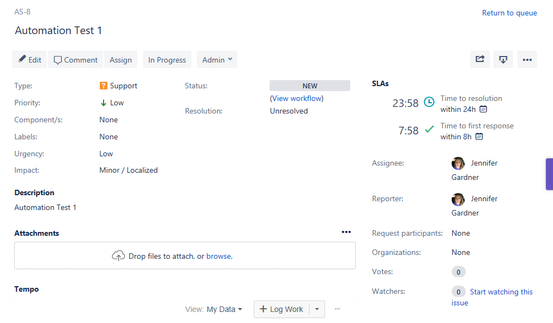

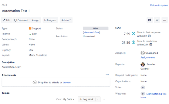

Why do you have 2 screenshots, one with assignee and one without it? How did the assignee get populated in the second screenshot? Probably that is why the rule is not executed?
Jennifer Gardner
July 26, 2018
I populated it manually. So when an incident is assigned I want the status to automatically change to 'In Progress' from 'New'. Thanks.
July 26, 2018
Your automation rule is triggered only when the assignee is not empty when the issue is created. Try populating the assignee on the create screen itself and see if that makes a difference.
Jennifer Gardner
July 26, 2018
Ok, thanks. So how do I go about creating an automation rule to achieve what I need? When the incident comes into the Service Desk it has the status of 'New'. When it is assigned to an agent I want the status to automatically transition to 'In Progress'.
July 26, 2018
I am afraid you can't do this automation tool as it doesn't support an "Issue Assigned" event. You might want to look at other plugins like Scriptrunner or JIRA Toolkit to do it.

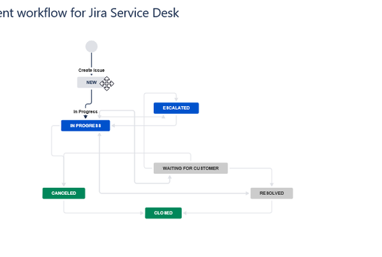

Below is a copy of my workflow. Apologies, but I'm not sure where I need to look for the workflow logs.
I can manually set the transition to 'In Progress' from 'New'.
Workflow.pngI will give your suggestion a go i.e. "Entered Status - New" option.

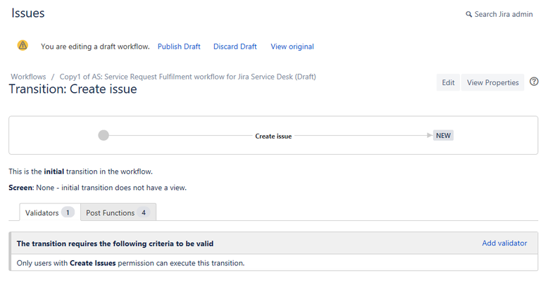

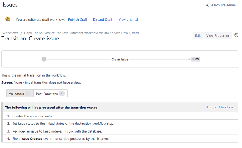

July 25, 2018
You can click on the "In Progress" transition and see if it has workflow conditions or validators under it that will prevent the transition up on creation.
The logs I was referring to can be found in atlassian-jira.log file under JIRA_Home/log folder.

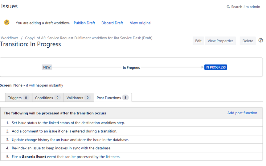

Create issue validators.pngCreate issues post functions.pngIn Progress post functions.png

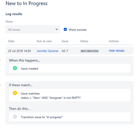

Found the logs :-) can't see anything that mentions any errors.
July 25, 2018
Cool. Reviewing your screenshot again, it looks like the issue AS-7 didn't match the query you have. Can you check why? Maybe it has a different status or it already had an assignee by default?
