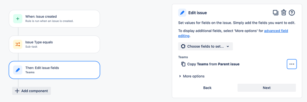

HI @Mika Barnett-Ohori
Setup a simple automation like this:
