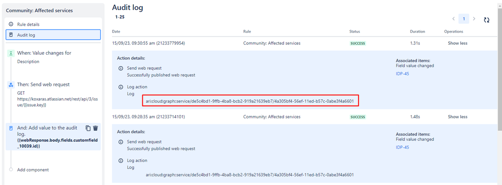

There is a way to get the ID of that service. And this is to use the "Send Web Request" component to get the issue and then drill down to get the Affected Services custom field, which includes the id of that service. Then use the {{webResponse}} smart value to get the id. It will look similar to this:
{{webResponse.body.fields.customfield_10039.id}}
Where on my instance customfield_10039 is the Affected Services field.
I would agree that using a smart value, as you did, would be a much much easier way. However since that smart value returns the name of the service, I would say that it's going to be impossible to get the id..
Let me know if the above helps!

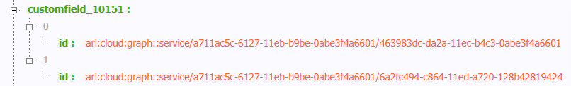

I tried that and I I got the same value by calling the API via https://<ourJiraURL>/rest/api/2/issue/DFXXREL-2?expand=names. That gave me an ID value in a format like yours.
"ari:cloud:graph::service/a711ac5c-6127-11eb-b9be-0abe3f4a6601/463983dc-da2a-11ec-b4c3-0abe3d4a6601"
Sadly, this ID value does not work in a JQL search.
When creating the JQL, it converts the service name (e.g. CRM) into a longer, uglier key, like this, which I don't see in the API response, and I'm not sure how it's generated.
"b:YXJpOmNsb3VkOmdyYXBoOjpzZXJ2aWNlL2E3MTFhYzVjLTYxMjctMTFlYi1iOWJlLTBhYmUzZjRhNjYwMS80NjM5ODNkYy1kYTJhLTExZWMtYjRjMy0wYWJlM2Y0YTY2MDF="
