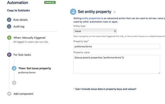

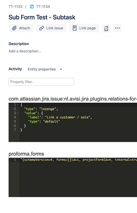

We are attempting to copy an entity property from a parent issue to a subtask. Everything is working as expected; however, when we use the Set issue property it writes the values as a string and adds quotation marks around the json we are adding, which makes the JSON invalid.
Is this a bug or is there some work around?
The automation rule we have created is:

The result is this

So I'm guessing for you, @Simon H, it's the {{issue.parent.properties."proforma.forms"}} that's introducing the extraneous quotation marks.
