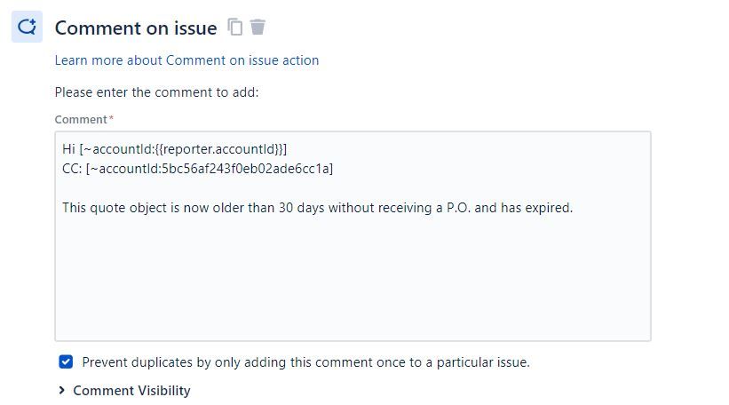

If the condition passes it is to write a comment.
I have "Prevent duplicates by only adding this comment once to a particular issue" ticked.

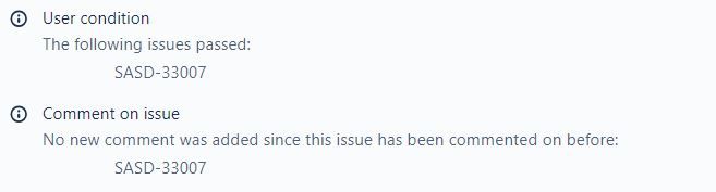

I expect that the comment will be written at least once.
When reviewing my audit trail I see the automation ran but with the below message but when I checked the issue, my comment was never written ever.
Comment on issue
No new comment was added since this issue has been commented on before:
It looks like it did not write my comment because a comment existed even though my comment did not exists.

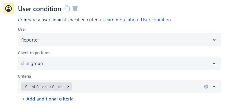

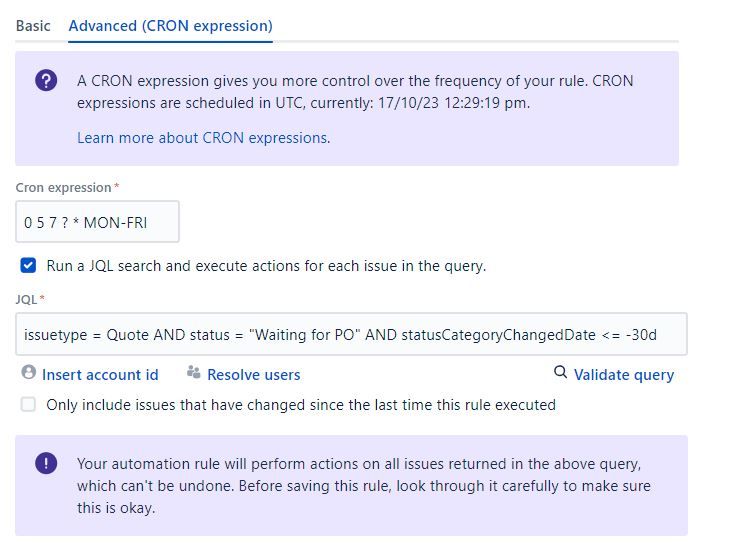

2023-10-17 14_31_01-SA Service Desk - Details - Service project - Jira Service Management.jpg2023-10-17 14_30_45-SA Service Desk - Details - Service project - Jira Service Management.jpg2023-10-17 14_29_31-SA Service Desk - Details - Service project - Jira Service Management.jpg2023-10-17 08_34_13-SA Service Desk - Details - Service project - Jira Service Management.jpgHi Everyone,
Here is the automation and audit.

HI
I posted the automation as you have suggested.

HI @Patrick Till
in your JQL I see that you look at statusCategoryChangedDate, this looks at the category the status Waiting for PO is in.
So category "to do", "in progress" or "done", I think this my cause the issue if a comment has been added before when the issue also was in the same status category.
JQL I would try:
issuetype= Quote and status = "Waiting for PO" and and updated <= -30d

The thing I noticed is that it sometimes does run successfully but won't write the comment and I was trying to find out why it is not writing the comment even if it was successful.
Log Message :- No new comment was added since this issue has been commented on before.
