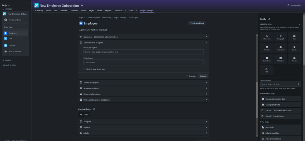

I've created some "People" fields and added them to the "Employee" Issue type, see screenshot below.
New Employee Onboarding - Assignee Fields - Screenshot 2023-11-02 161047.png

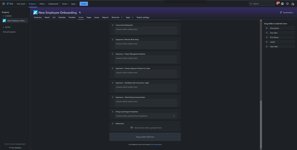

Then over on the form, the fields are not visible, shouldn't they be on the right hand side for use? Is this a permission issue for myself perhaps? see below screenshots.
Above shows that I am using the "Employee" Task type to use its fields.
Here you can see there are a number of custom fields but the "people" fields do not show. They had labels that contained the word "Assignee".

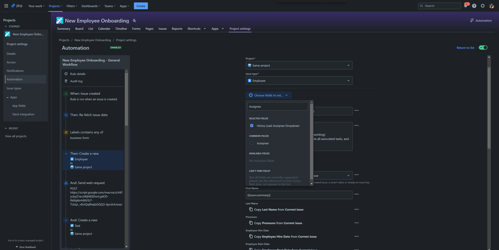

And then below, is a picture of the automation process, and in particular the "Employee" task type, where I copy the values from the form to this task type, and I hope to apply the Person Assignee fields to the follow up tasks it creates.
New Employee Onboarding - Automation Fields - Screenshot 2023-11-02 162005.png

After some digging, you seem to be running in to different problems related to Team Managed project in Jira Cloud
This in relation to people fields in automation (2) and forms (1)
  1. What you see looks to be a bug/limitation in the Form in a team-managed project that it cannot display people fields in the form. It looks like this can be related to this issue: JWMCLOUD-192
  2. Relating Custom fields: All People custom fields in team-managed projects currently aren’t supported by Jira Cloud automation. This means that your automation rules won’t be able to access values or set values in any People fields.
The only current solution I can give you is to use a Company Managed project setup.
