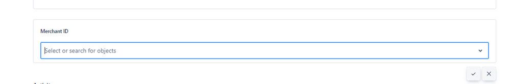

I am trying to make automation to update a custom field type (assets objects) using data found within an issues summary.  The summary will contain a unique 5 digit ID at the end that I can pull using issue.summary.right(5) but I cant seem to then use this data to select to corresponding asset. In the asset scheme the object type is called Merchants with the attribute called merchant_id (text).

You can use the Filter Issue Scope (AQL) field to reference system fields from within the issue like “Assignee” and “Project”. For example, if you wanted to only show a list of merchants with the corresponding merchant_id, you could configure the Filter Issue Scope (AQL) field by typing objectType = “Merchants” AND "merchant_id" LIKE ${issue.summary.right(5)}.

Thanks for the above, I tried this and it still showing all merchant_ids as options when I select the custom field option. If I added the filter issue scope AQL can I have the custom asset object field auto populate?
