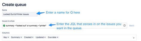

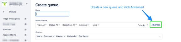

@Michael Castro,Agree w/ Raynard that you need to do a bit of reading. With that said to answer your request for snapshot...
  1. go to the project
  2. go to Queues
  3. click New queue at the bottom
  5. enter something like below. actual will vary greatly on your needs.queue2.jpg
  6. repeat w/ additional Qs as necessary

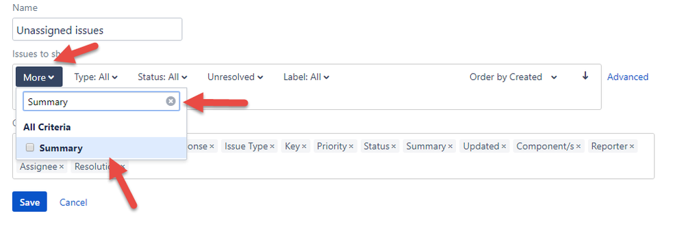

You can set up queues that will only pull in tickets with certain words in the summary/description. You can do this by editing queue, click more, and typing the field you would like to identify. If you plan on using automation, I suggest global. We place tickets in queues based on component (because the queue configuration will look for component). It really depends on how you have your queues set up to identify issues.
