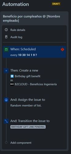

Hi Community, i´m a beeginer JSM Admin and i need help to create an automation.
Steps for the automation:
  1. - Schedule: Create an issue once time per year (birthday date, i used a Cron expression).
  2. - Then: Assign the issue to a user in a defined list (random).
  3. - And: Transitioned the issue to status (ex: "waiting for customer")

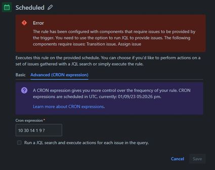

I create that, but can't save the rule due to appear error below:
Anyone can described me the reason why the system request to run JQL search?
In that case, what sentence i will must to write to save the rule and test the functionality?
Thanks a lot!

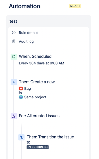

Hi @Dario Alarcón,
Welcome to the community! It seems like you need to define which issue will be transitioned. You can use a branch for that like the example below
Let me know if it worked.

Hi @Dario Alarcón
That's was just an example, you can ignore how my trigger was configured. I believe there's a missing component in your automation rule, specifically a branch. To clarify, the rule should state that the issue being transitioned is the one that's created when the automation triggers. To address this, you'll need to create a new branch.
