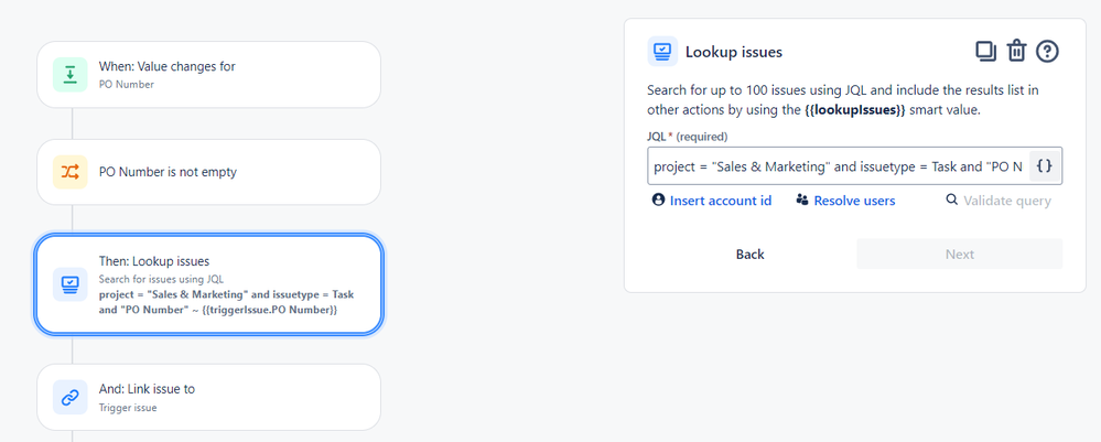

Can you share a screenshot of the variable? Also, why are you using a variable and not just using: project = "Sales & Marketing" and issuetype = Task and "PO Number" ~ {{triggerIssue.PO Number}}
I assume that the Audit log is not returning a value and therefore no link is happening?

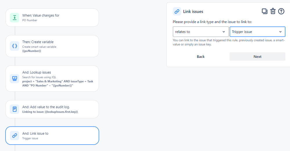

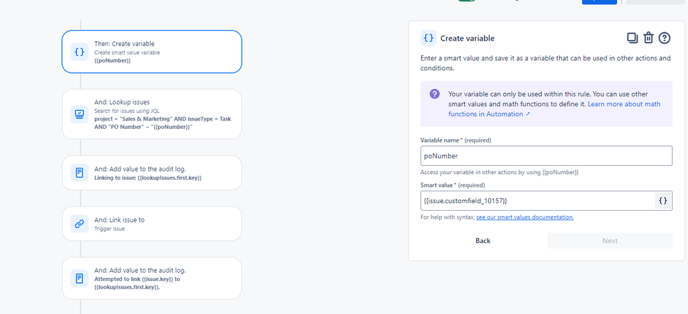

I am new to this that is why i am using variable, please suggest which way is recommendedUntitled2.pngUntitled1.png

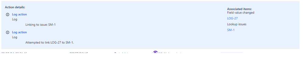

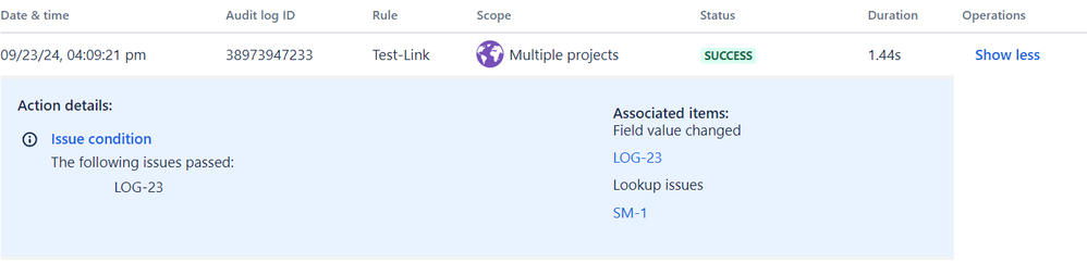

yes, i tried , its not working. please find screenshots.Untitled3.pngUntitled4.png

Thank you for sharing those. Try creating a Branch and moving those last two steps under that. The Link action looks like it is trying to link to itself because it is the trigger issue and is not relating to the result of the Lookup Issue.
I just did the same with using a Branch based on JQL instead of Lookup Issues (just use the same JQL you have in your lookup issues right now) and then put the link issue action under that Branch.
