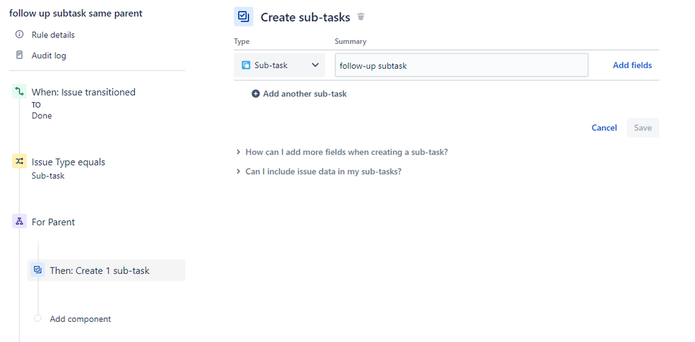

Hello,
   I am trying to create a rule that when a sub-task is closed, a new sub-task is generated. I want the new sub-task to be housed in the same parent issue as the trigger sub-task.
How can I do this?
Thanks.

Hi @Ben Weisman
first of all: I am not a experienced with service desk. Therefore I could just give input with my overall A4J knowledge.
Regarding your description I would suggest following rule:
Please let me know if this might help and solves your problem.

Ben Weisman
May 18, 2022
@Stefan Salzl This works! Thank you.
