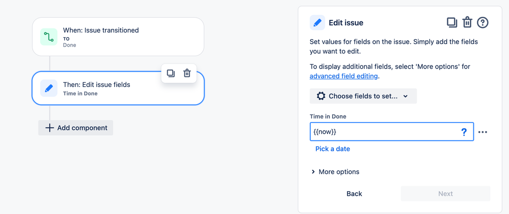

If you want the time ona specific status you can do like this.
1. Create a custom field
Settings -> Issues -> Custom Field -> Create Custom Field -> Choose 'Date and Time Picker' (Eg: Time In Progress) -> and add that field to your project
2. Create one automation rule to update 'Time In Progress' (It should trigger when the task transition to 'In progress'
3. Create another automation rule which will trigger when the task transitioned FROM in Progress
here the 'Time in Done' is my custom field
Cheers!
