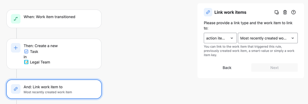

The reason this should work is the context of the rule. Because our trigger is action-ing the SALES work item, that's our context. So, the "copy" is taking all the links from the SALES item and adding them to the Marketing work item. Then, the follow-on Link action is still acting on our SALES item, but this time we want to link the Sales to our new ticket.

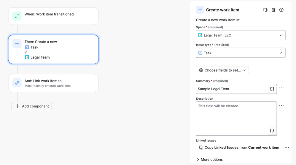

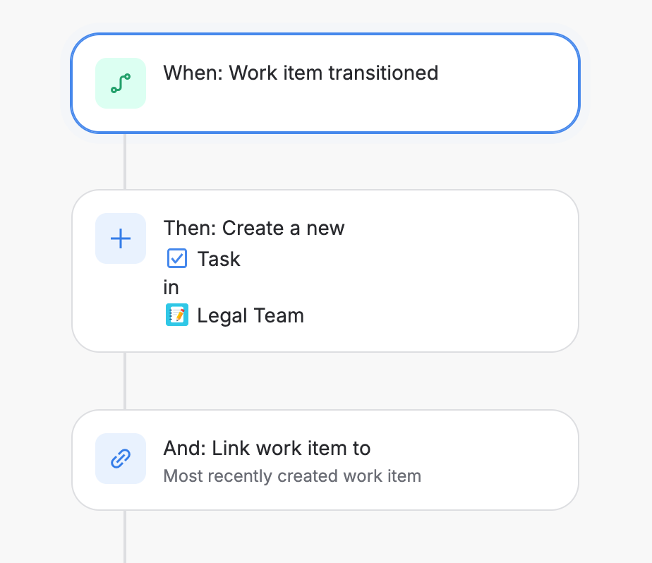

Here's some screenshot of how this should look. Forgive the rough testing nature of the rule, the structure should work.
and the copy settings for the "Create new work item action:
And finally the "Link Work" action:
Give this a go and let us know if it works out!

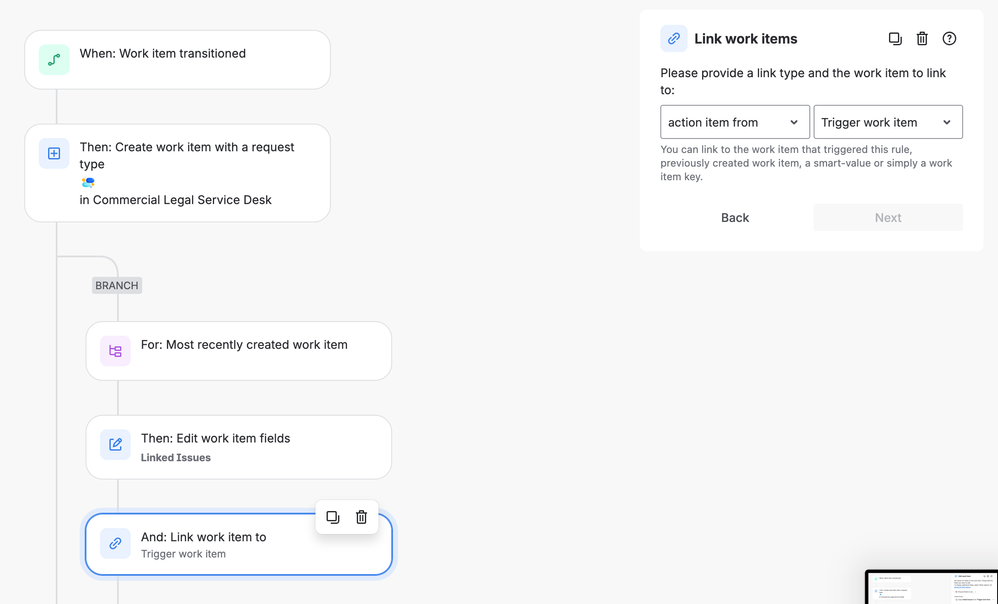

Robert DaSilva
December 5, 2025
@Eric Younkin Ah, did not realize you were creating work within JSM spaces.
The "Create work item with request type" does in fact support setting the Linked Work Items field, but it needs to be part of the Request From in your JSM Space settings. The other limitation is that you cannot "Copy" like I proposed, you can only set the value when using this "Create with request type" action.
What you can try is this:
  • TRIGGER
  • ACTION: Create with request type
    • Set all your regular values here, with the exception of the linked items
  • BRANCH: For most recently created work item
    • ACTION: Copy linked issues from TRIGGER work item
    • ACTION: Link work item to TRIGGER work item
  • Outside of branch, repeat the above for the second, third, etc.
This change should work. The big note is the context. Because we're now doing linking within a branch, the actions are no longer being taken on the triggering work item in your Sales space, but instead the brand new work item in your Marketing space.

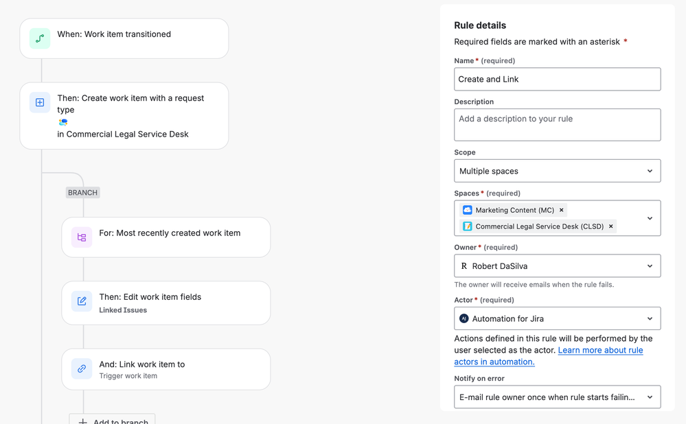

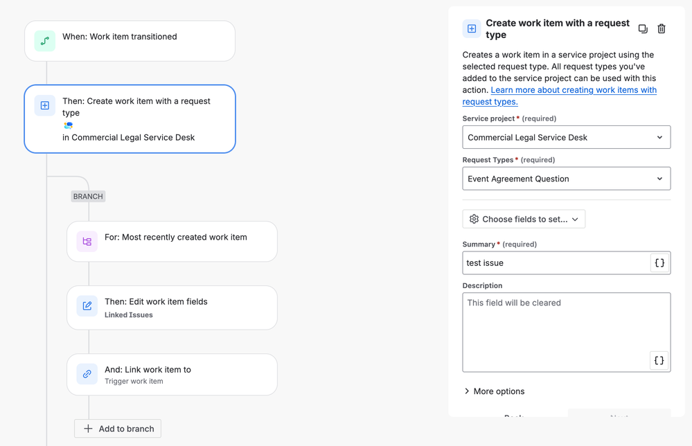

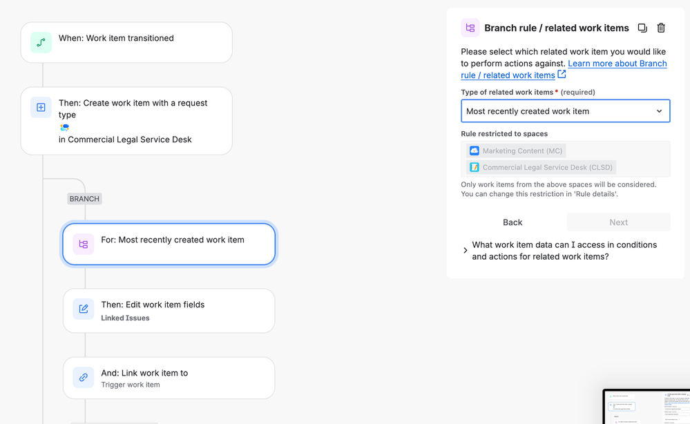

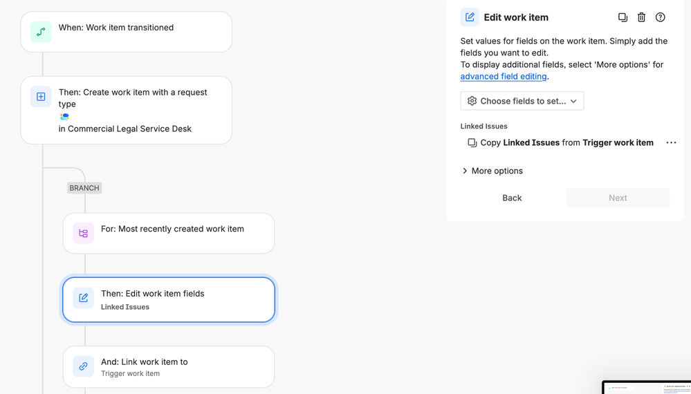

Here are some screenshots showing the new rule layout:
Screenshot 2025-12-05 at 8.08.12 PM.pngScreenshot 2025-12-05 at 8.08.22 PM.pngScreenshot 2025-12-05 at 8.08.28 PM.pngScreenshot 2025-12-05 at 8.08.34 PM.pngScreenshot 2025-12-05 at 8.08.40 PM.png
Like Eric Younkin likes this
Eric Younkin
December 6, 2025
@Robert DaSilva - this worked! Slight tweak as I just created a regular issue type to use your copy trigger issue link, and then assigned it a request type immediately after, but this worked perfectly!
