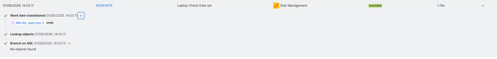

Ben Whiteley
January 8, 2026

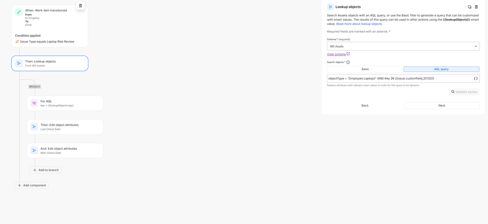

Hi Marc,
Thanks for your help - I am making progress. However i must be missing something, as the above does not find any objects
Here is what i have:
and this is the log from the rule run:

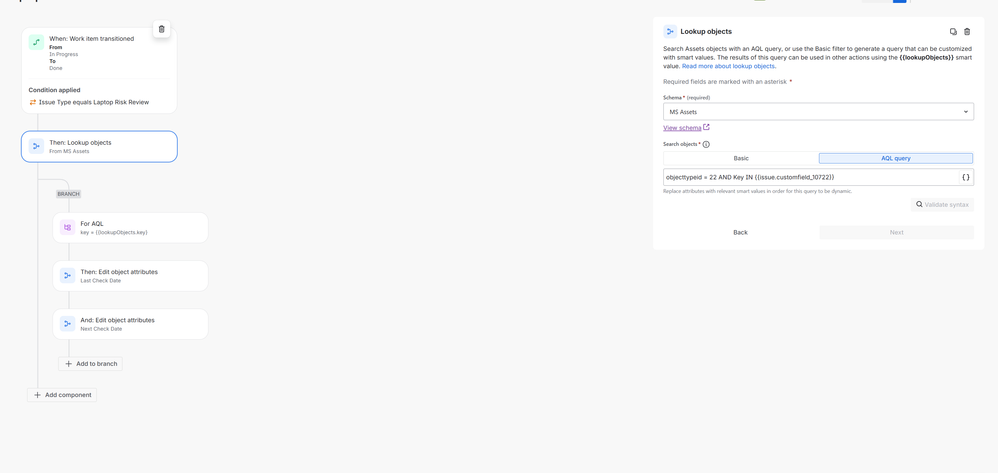

Ben Whiteley
January 8, 2026
ok - thanks - changed that back, and still no objects found.
Appreciate your help on this. Its been driving me mad

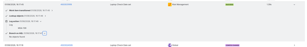

Ben Whiteley
January 8, 2026
HI @Marc -Devoteam-
Tried the alternative, still no objects found
The custom field is an assets object field yes
Added a log action (gamechanger - did not know about this!) and the value is returned correctly from the field, using both methods you mentioned.

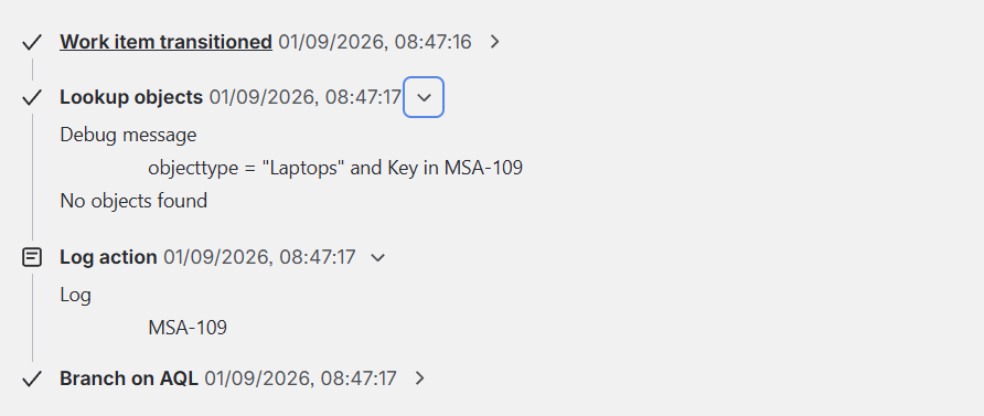

Ben Whiteley
January 9, 2026
Hi Marc,

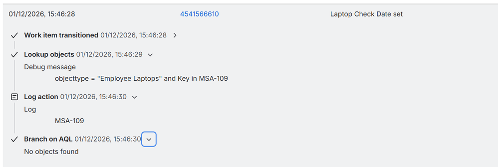

Changed as istructed, and this is the log :
This is the assets :
I have no idea why it is not finding them.

Marc -Devoteam-
January 12, 2026
Hi @Ben Whiteley

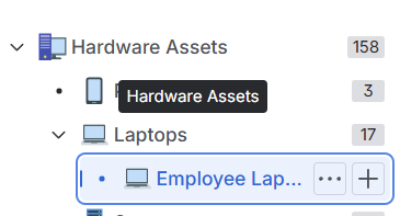

Is the object in Laptops or in Employee Laptop?
Ben Whiteley
January 12, 2026
They are in Employee Laptops, but i have tried that also and the result is the same

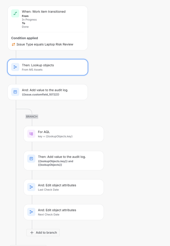

Do a log action in the branch, as first action.
smart value in the log action {{lookupObjects.key}} and {{lookupObjects}}
Is there a result?

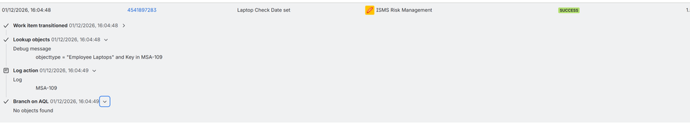

Ben Whiteley
January 12, 2026
I did this  - and nothing logged
here is log
Marc -Devoteam-
January 13, 2026
HI @Ben Whiteley
Can you change the AQL in the branch to {{lookupObjects}}
Ben Whiteley
January 13, 2026
Brilliant! It works now. I can not thank you enough for your help!
