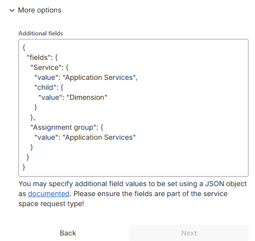

Since the rebranding of Project to Spaces, all of our automations have been partially failing with "The set fields may be unavailable for this space/type" error. This looks to relate to a custom field set via the JSON part of the Create Work Item action.
These were all working before the change, and nothing else has changed (from our side, anyway).

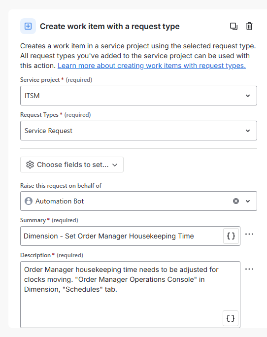

2. images that show your complete rule.
3. images showing the details of any relevant actions/conditions/branches.

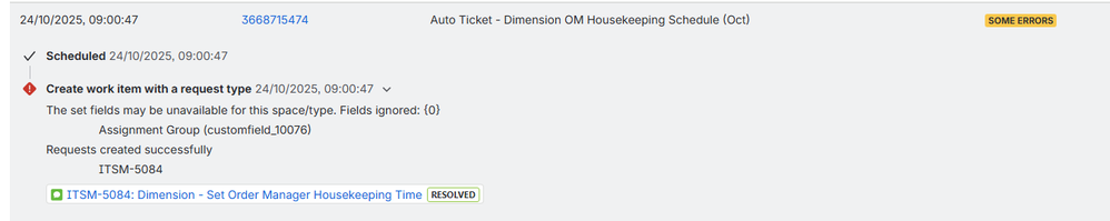

4. images showing the Audit Log details for the rule execution.
5. Explain where the issue is.

2/3.
4.
