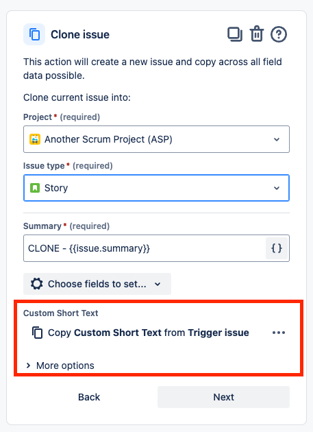

In your Automation Clone Action you might have something that looks like this:
The "Custom Short Text" field in the destination project is an entirely separate and unique field from the "Custom Short Text" field of the source project, even though they have the same name.
The Automation rule can get "confused" about where to find the data and where to deposit the data.
The way to ensure the right data is being copied from the correct field and into the correct field is to use the Advanced Editing with JSON (More options) feature.
https://support.atlassian.com/cloud-automation/docs/advanced-field-editing-using-json/
With that you can explicitly identify the destination fields with their custom field IDs rather than their names, and you can explicitly identify the correct source fields with their custom field IDs also.

Team Managed project custom fields can't be shared.
The only other alternative is for the custom fields to be recreated as Global custom fields that can be used by both Company and Team Managed projects. You would then add those Global fields to both projects. In the Service project you would have to move all the data from the current project-specific fields into the Global fields. You would probably have to make other changes to filters and forms and request types to accommodate that change.
If the Team Managed projects use Global custom fields then the data can be copied directly as I showed in the image in my previous reply.
