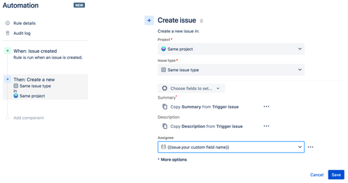

Per your description, I understand you want to configure an automation rule to create a new issue when an issue is created, copying the values from the original issue and adding the user selected in the user picker custom field of the original issue as the reporter on the new issue created. Is that correct?
You can achieve it by following these steps:
  1. Navigate to your SD Project > Project settings > Project Automation (Not Automation)
  2. Create a rule that will copy the values from the trigger issue and use the smart value {{issue.My custom field name}} to copy the custom field to the assignee of the new issue created. You can follow the screenshot below as a template:

After reading your request a second time, I see that you want to change the reporter of the issue, not the assignee. Sorry for the confusion.
That being said, please confirm if the user added to the issue custom field is a customer in your site and edit your Automation rule to add him as the reporter field, not as the Assignee.
