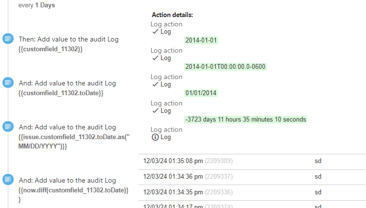

Its hard to understand what the issue could be without screenshots of the rule and audit log.
I am sharing a screenshot of example below and let us know what is not working.
In my example, I am storing date in the format of YYYY-MM-DD in a custom field. This is a text field.
and I am logging various values for you to refer.
So when I log just {{customfield_11302}}, I get output of date but it is a string. I cannot do date operations on it yet. I have to convert it to date. So thats my second log. {{customfield_11302.toDate}}
As you can see in my third log, I can "format" this date by specifying the sequence (MM/DD/YYYY) in my case.
Finally, to do a diff, I am using the customfield.toDate to calculate the difference.
The diff function takes 2 dates.

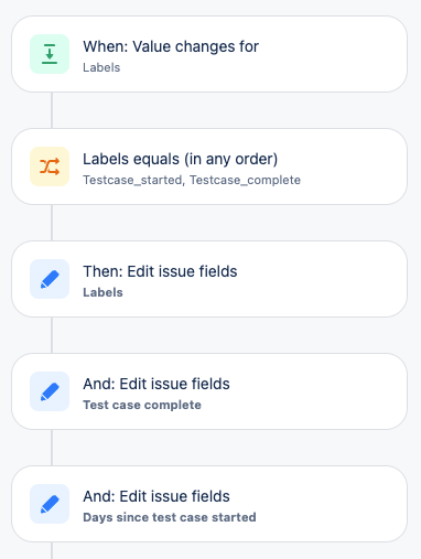

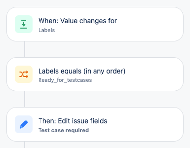

For context, I am tracking labels added to an issue to calculate the time to progress through various stages of testing.
  • Automation 1: When label 1 is added, I log the date/time in custom field 1 with {{now}}.
  • Automation 2: When label 2 is added, I log the date/time in custom field 2 with {{now}} and remove the first label. I then calculate the difference between the 1st label being added and now (the addition of label 2) to show the time between those steps and log that in custom field 3.
  • Automation 3: When label 3 is added, I log the date/time in custom field 4 with {{now}} and remove the second label. I then calculate the difference between the 2nd label being added and now (the addition of label 3) to show the time between those steps and log that in custom field 5.
  • Automation 4: When the issue is finally transitioned to the next stage, I log the date/time of that transition in custom field 6. I then calculate the difference between the 3rd label being added and now (the transition of the issue) to show the time between those steps and log that in custom field 6.
