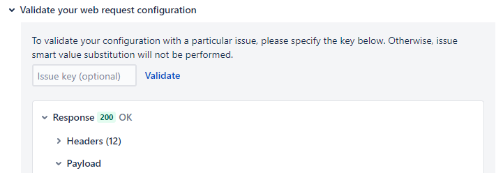

I have a web response that validates correctly
The payload returned is:
  "access_token": "<snip>",
  "refresh_token": "<snip>",
  "scope": "useraccount",
  "token_type": "Bearer",
  "expires_in": 1799

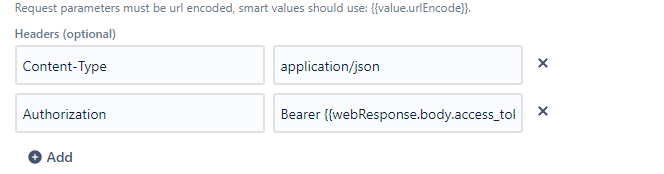

I have another send web request that needs to use the access_token in its Authorization header value like so:
The full value is Bearer {{webResponse.body.access_token}}
Thus far I have not been able to successfully build this string :( and validating the second request returns authorization failed. I have tested copy/pasting the access_token into the header and it does work

Looks like I've been able to answer this myself
The custom field value is text so it looks like in both cases all I had to do was remove the .value
{{issue.customfield_123456}} worked.
