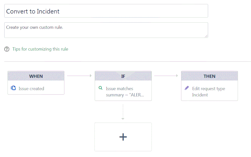

I'm trying to automate the issue type when certain subject lines start with a certain set of keywords etc.  In this case I want to match any subject line that starts with "ALERT: xxxxxx" and change the issue type from our email default of Service Request to Incident.

Dear @Paul Stewart ,
you can do what you want by creating your own custom automation rule:
convert.gifNote: you can change the request type only, if the issue type of the new request type is the same.

Thank you - I started there however you cannot change the issue type using JIRA automation ... only the request type.  I need to change the issue type in this case.  Thank you.
the problem is that Request Type : Issue Type is a "many to one" relation. Means, you cannot just change the Issue Type without changing the Request Type.
What you could do, is fire a Webhook, that is calling a script, that moves this issue to another one by calling a REST method.
If this doesn't work you could transition this issue. In the workflow you could call a groovy script moving your issue (with plugin).
