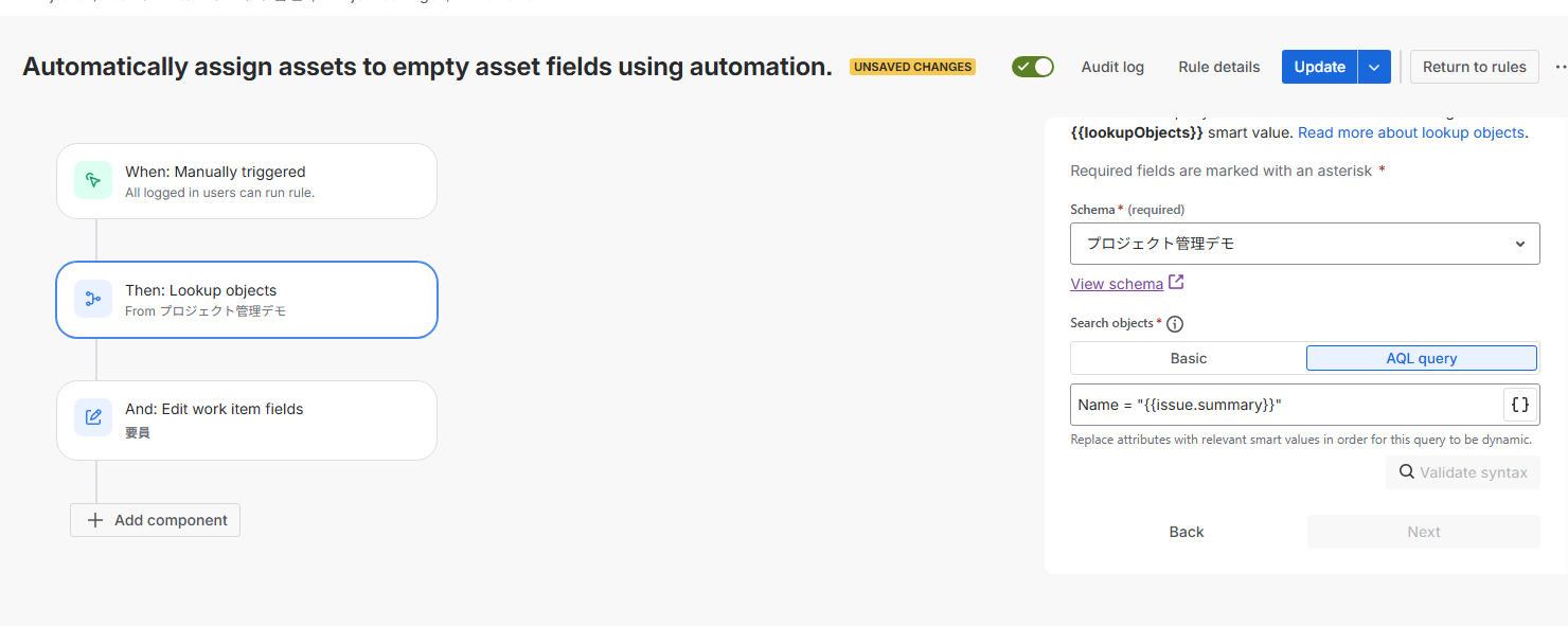

  2. Search Assets (lookupObjects) for an object with the same name as the summary of the triggered issue

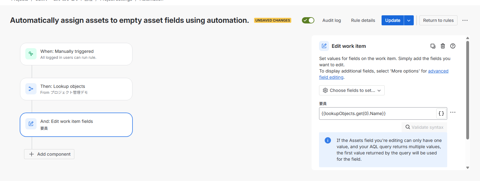

  3. Edit the work item field
    Insert the obtained object into the empty asset-type field.

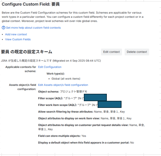

  • However, I cannot automatically set the object in the asset-type "Personnel" field, and an error occurs

Automation screen
Asset-type field settings

  • Lookup Objects: Using AQL Name = "{{issue.summary}}" against schema. This is correct for finding the matching Personnel object.
  • Edit Work Item: You’re trying to set the fieldusing {{lookupObjects.get(0).Name}}.\ → This is the problem: Assets fields require the object ID, not the Name string.
Why it fails
  • JSM Assets fields don’t accept plain text; they expect an object reference in the format: { "id": ":" }
  • Using Name only works for comments/logging, not for setting the field.
You have two options:
Option 1: Advanced JSON (recommended)
In the Edit work item → More options, use:
  "fields": {
    "customfield_XXXXX": [
      { "id": "<<workspaceId>>:{{lookupObjects.get(0).id}}" }
  • Replace customfield_XXXXX with the ID of the Personnel field.
  • Replace <<workspaceId>> with your Assets workspace ID.
  • If the field supports multiple values, loop through lookupObjects:
  "fields": {
      {{#lookupObjects}}
        { "id": "<<workspaceId>>:{{id}}" }{{^last}},{{/last}}
      {{/lookupObjects}}
Option 2: AQL in Edit Action
If the field supports AQL input, use:
Key = "{{lookupObjects.get(0).Key}}"
This works only if the field allows AQL assignment.

The issue has been resolved. Thank you for your support and assistance.
