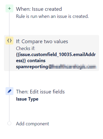

Basically, I've got an email account connected to Jira that has multiple aliases on the mailbox and I want to be able to automatically change the issue type based on the email 'to' field.
Use case:
Emails that are sent to spamreporting@mydomain.com, will be changed from the default placement of service request TO spam reporting (a custom issue type i created)
FYI I already matched my source to destination workflow - so thats all good there.
After much investigating I finally found how to add logging, validate json and get my email "to" field. Wow! (im pretty new to this so give me a moment here).
However, now I've changed the rule from manually trigger to Issue Created - it doesnt trigger. So I've tested a few different triggers, but no luck either. I thought about a time condition, but I don't really want to put in a run every 10 seconds / 30 mins / 1 hour type of trigger either - thats just barbaric.
Any ideas on what trigger i need to put in OR if there is just a way simpler method that what im trying to achieve?
TL;DR - why is my compare statement only working by manually triggering the automation rule and not for Issue Created?

Checking your use case, it seems that the email information is taking a while to be populated, that’s why when using the “Issue created” trigger is not working.
What I’m trying to say is that, when the issue is created, the field is yet not populated, so the automation runs when it’s still empty. Using Manual trigger works because it takes a while until you open the ticket and click to run the automation.

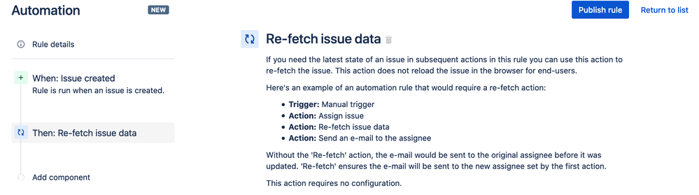

You can try adding an action called “Re-fetch issue data” before adding the condition to try to slow down a little bit the automation. I don’t have any email and aliases to test the same scenario as you, so please, take your time to test and let us know how it goes.

Yes! This is exactly what i needed in the automation. I thought the field was still being updated and thus not triggering, excellent action to use! That resolved the issue, thanks you so much!

thanks for the reply John. The rule is triggering, just the condition wasn't matching. The reply from @Angélica Luz with the re-fetch action placed in my rule after the the 'issue created' trigger is perfect.
