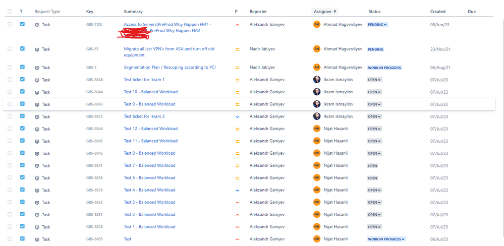

Hi @Rilwan Ahmed ,
I did it as you said but i faced with issue,
I have created automation process and indicated 3 employee
Ahmad - originally had 3 tickets
Ikram - originally had 2 tickets
Nijat - originally had 1 tickets
Then i launched automation process
As expected first ticket was assigned to nijat - Test 1 - Balanced Workload
Second to Nijat - Test 2 - Balanced Workload
Amount
Nijat - originally had 3 tickets
But then something went wrong that third ticket was assigned to Nijat also and fourth also
Then i deleted Nijat from automation process
Amount
and ticket was assigned to Ikram(Test 9 - Balanced Workload) and next to ikram(Test 10 - Balanced Workload)
Then i added Nijat again to Automation process
Amount
Ikram - originally had 4 tickets
Nijat - originally had 8 tickets
And something what i don`t understand next new ticket was assigned to Nijat again(Test 11 - Balanced Workload), and again (Test 12 - Balanced Workload)

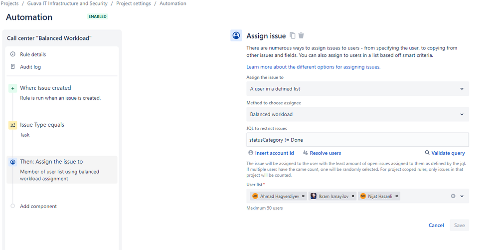

Maybe i need to change something in field "JQL to restrict issues" - "statusCategory != Done"
Hi @Aleksandr Ganiyev ,
System checks for all the tickets assigned to the user and which is not resolved. Not only the present created tickets. Please run the JQL for three users and see their total non-resolved tickets.
In this screenshot(previously i have sent and now below) all tasks(issue type - task) which these employees have in this screen.
As you can see in screenshot with automation process i indicated issue type - task
Your project has atleast 8848 tickets (I see key GIIS-8448). Please check the count for each users using JQL provided in previous comment. Don't check only tickets created recently.
Ok i got it, i have checked it again and yes you are right this automation process works and assigns tickets depending on all amount of al open tickets but if i need to launch this process for one issue type - for example only for issue type "Task" as i mentioned in my case i won`t be able to do it?
As i see now it is not working by this logic.
