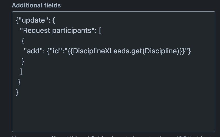

Please see JSON below.

Piet Pieters
July 24, 2024
hi @Brandon Elie ,
I think I see the problem here.
Would it be possible to print (log) the smart value and show us what it returns?
The add will add a single user to the values already in the field, this works as expected (I have tested it.)
However, you are trying to add a list of users all at once, I am wondering if what's in your variable is in the correct format.
It should be an array of json objects looking like this:
