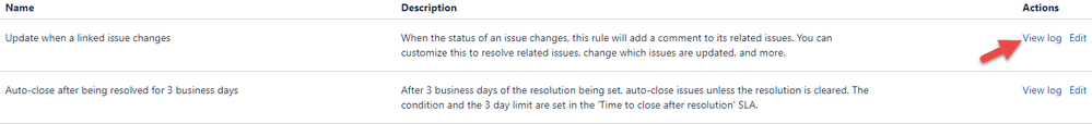

View the logs of that automation and see where it has been successful.
Alison Files
August 20, 2018
The Transition on Comment rule is running successfully and changing the status to "Waiting for Customer".  That means an email is going out from the service desk to the customer - does it automatically send an email when the request is approved?  That would cause the transition.
