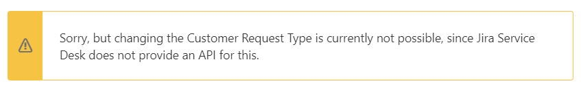

I've looked into using JMWE and 'Automation for Jira', but neither seem to be able to do what I need:
"Sorry, but changing the Customer Request Type is currently not possible, since Jira Service Desk does not provide an API for this":
I'd really appreciate any help to automate changing the Request Type.

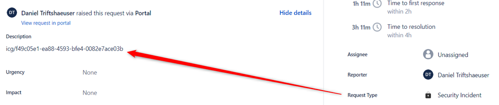

Hello Derrick,
there is an option for you to acquire this value yourself.
We did this by including the "Copy value from other Field" post-function and copied request type to description.
This way the value is easily extractable, even for cloud users.

Dan,
Atlassian Support has confirmed your statement. It's currently not possible to 'set' this value in the Automation. It should be possible within the deprecated Legacy Automation tho (have not tried this).
An update should be coming out 'shortly' that enables this.

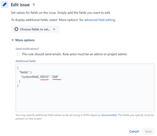

I just found an easier way to do this without having to open a ticket to get DB information. Steps are below.
1. Find out what is your custom filed ID for "Request Type"
2. You will now need to know the ID number of your "Request Type". To do that, do the following.
3. Go back to your automation. For my case, I wanted to update the "Request Type" based on an issue type that was created. My requirement is that, if an issue type is "BeyondTrust", update the "Request Type" filed to "BeyondTrust".
This was a quick edit and worked well for me.

Here is how I managed to change request type in Issue Transition.
First you need to get a special request type value from db before you use postfunction. To do that:
1) Create a request in JSM with value of request type that you want to CHANGE INTO.
2)Create a postfunction on any transition (I used loop) to copy value from Request type into i.e Description
3) Use newly created transition and you should get sth like that in description
abc/d1sad1sd1-rt22-4123-ber2-3123a3wgy1
It's a value of request type from db
4) Now go back to your workflow. Remove postunction created in point 2 and add postfunction "update custom field" -> select "request type" -> paste value from point 3-> abc/d1sad1sd1-rt22-4123-ber2-3123a3wgy1
That's it. Request type should change to one that you want during transition.
