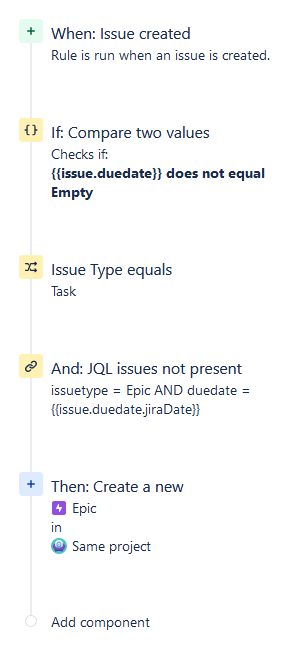

Hi @Cory Cigas
after re-reading your requirement I do believe the following rules applies rather than the previous one - however, I am still not clear how you define the 'parent', for now I assumed as an "Epic" which made the new rule look like:
I am now really interested what you find out when you test all this.

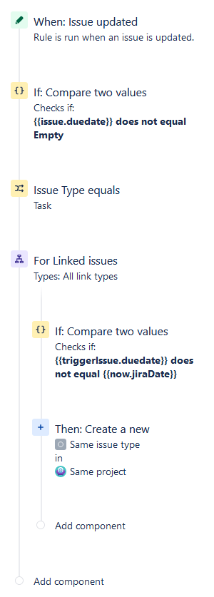

Hi @Cory Cigas
I did a few tests using Automation lately on this but I am not sure if I fully understand your setup and/or requirement.
You say that "once a task is created and assigned a date" a parent ticket should be created. Could you please be more elaborate on this?
I could image a task which is then linked to another task. From my understanding you are not referring to a sub-task because you could not create one if it had not already a "parent".
In your second post you stated if "there are no parent tickets on that due date" - do you mean by that if there are no linked tickets with the same due date?
From my understanding the parent is where you make the changes, correct?grafik.png
Please check and let us know if this helps.
