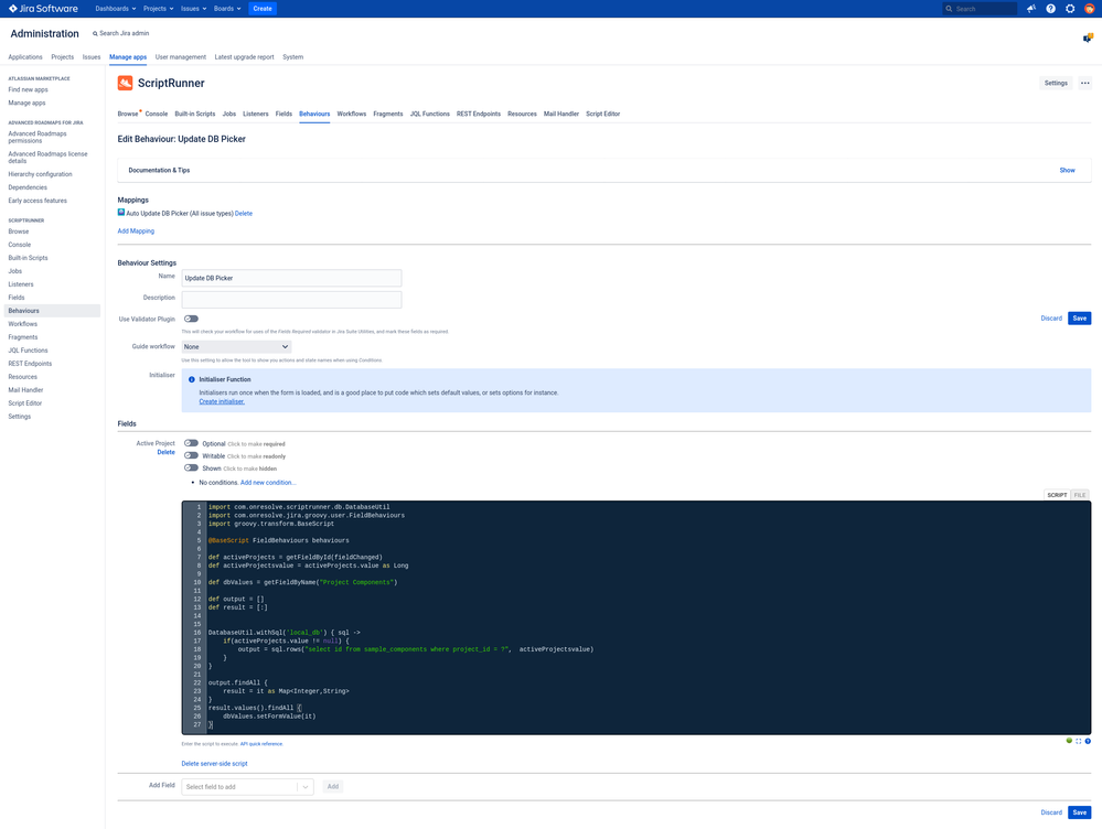

You can set up a Server-Side Behaviour for the first DB Picker, i.e. Project_Name and use it to update the option selected in the Client_Name DB Picker based on the option chosen in the Project_Name DB Picker field.
Below is an example code for your reference:-
import com.onresolve.scriptrunner.db.DatabaseUtil
import com.onresolve.jira.groovy.user.FieldBehaviours
import groovy.transform.BaseScript
@BaseScript FieldBehaviours behaviours
def activeProjects = getFieldById(fieldChanged)
def activeProjectsvalue = activeProjects.value as Long
def dbValues = getFieldByName("Project Components")
def output = []
def result = [:]
DatabaseUtil.withSql('local_db') { sql ->
if(activeProjects.value != null) {
output = sql.rows("select id from sample_components where project_id = ?", activeProjectsvalue)
output.findAll {
result = it as Map<Integer,String>
result.values().findAll {
dbValues.setFormValue(it)
Please note, this sample code is not 100% exact to your environment. Hence, you will need to make the required modifications.

Below is a print screen of the Behaviour configuration:-

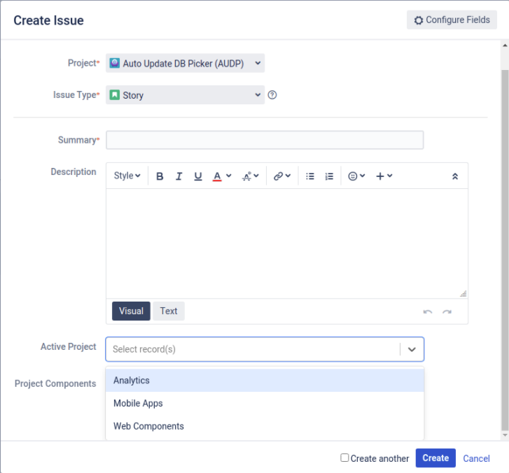

1) The Active Project DB Picker List

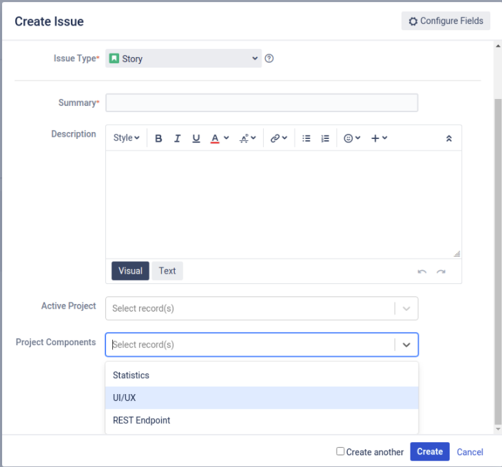

2) The Project Components DB Picker List

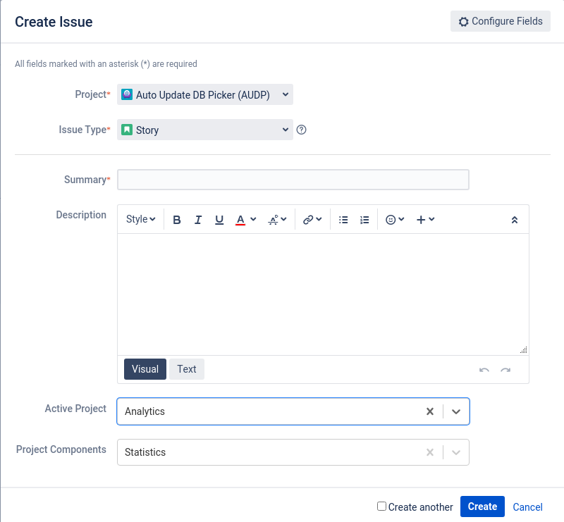

3) If the Analytics option is selected from the Active Projects DB Picker, the Statistics option is selected automatically in the Project Components DB Picker as shown in the image below:-

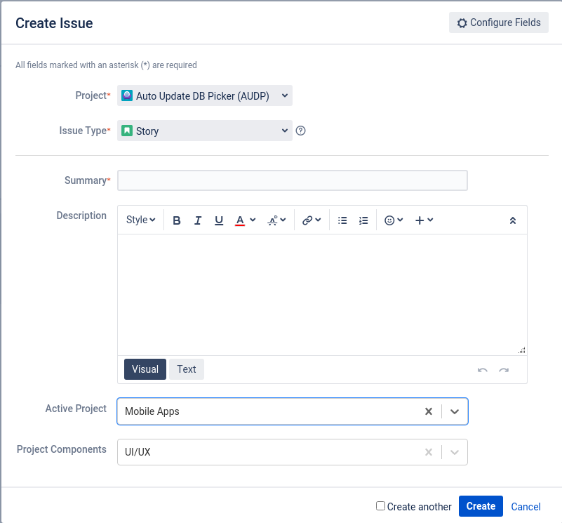

4) If the Mobile Apps option is selected from the Active Projects DB Picker, the Statistics option is selected automatically in the Project Components DB Picker as shown in the image below:-

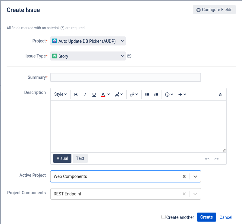

5) If the Web Components option is selected from the Active Projects DB Picker, the REST Endpoint option is selected automatically in the Project Components DB Picker as shown in the image below:-
