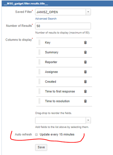

Hi,
i have a question about auto refresh result on filter in dashboards. Can i set action on auto refresh often/more then 15 minutes. See this function on screen,

Hi!
Not in the standard UI, you'll need to do some coding.
You've got two problems to code around.
First, the UI doesn't let you go below 15 minutes. This is an arbitrary value, I'm guessing it was chosen by Atlassian to balance the refresh convenience against the possibility of having large numbers of users having dashboards. Drawing a dashboard can be very resource intensive as they can have lots of filters on them, and lots of users can be using them, so you don't want them running at a high frequency. You'll need to dive into the core code to change that value.
Now, bearing in mind I just mentioned the load imposed by dashboard...
Second, dashboards don't work on actions. They work by running their queries when they are visited or refreshed, either by the user or by the auto-refresh. If you want them to refresh on the terms you've specified, you're going to need to write a lot of code to catch any events that should cause a refresh, and somehow feed that to all the dashboards so that they can redraw themselves. That's potentially a lot of code, imposing a heavy load as it runs.
Cheers,
Gonchik Tsymzhitov

I second the warning on the performance hit. I have disabled all auto refreshing for my dashboards.

Probably not relevant for you since you asked over 3 years ago but maybe for someone else. This page shows how to do it
Modifying Gadgets refresh interval | Jira | Atlassian Documentation

OK. Thanks a lot for your answer. I wanted to create a slide dashboard with few critical information for us to presentation it on TV wall.
I think that i not resolve my problem in that way.

Certainly using auto-refresh is for a Wallboard instance of a dashboard is warranted but you are limited to the 15m interval.
