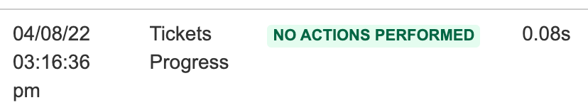

Can you please share an image of your rule and also the audit log from an execution where the comment isn't made but you believe should have been made?
Sampath
August 5, 2022
@Jack Brickey  Thanks for you response. Please find below details
Audit Logs
Action details:
Issue condition
The following issues passed: FHT-XXXX
JQL condition
The following issues did not match the condition: FHT-XXXX
Screenshot 2022-08-05 at 9.38.15 PM.pngScreenshot 2022-08-05 at 9.39.10 PM.png

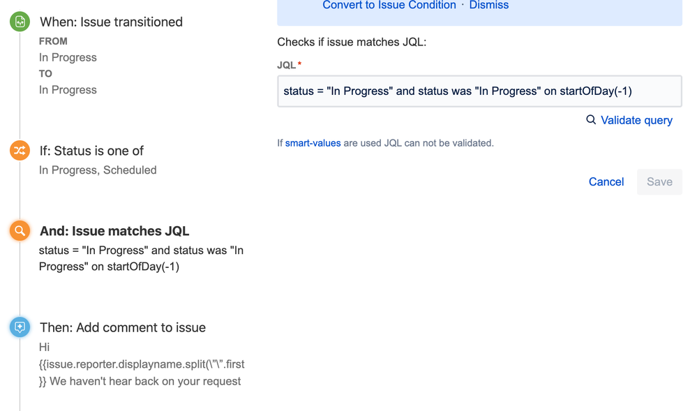

Sampath
August 8, 2022
I have this rule, looks like validation not done @Mark Segall

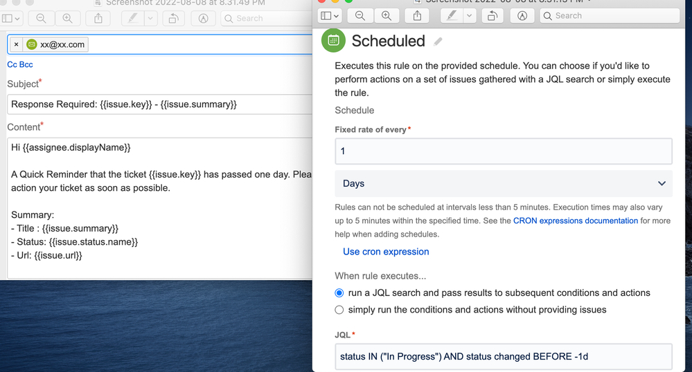

Mark Segall
August 8, 2022
Your trigger is set for "issue transitioned" and when issue transitions from In Progress to In Progress which means it will never trigger.  The trigger should be set to Schedule with one of the JQL queries that Jack or I shared.  Then you can eliminate your conditions.
Sampath
August 8, 2022
@Mark Segall  I have mentioned this in the rule any correction still? not sure . I have address the email id  Thanks
Mark Segall
August 8, 2022
This looks correct.  Can you share the latest screenshot of your rule along with the audit log?

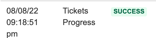

Mark Segall
August 8, 2022
Here i need to create new ticket and check for tomorrow or it will take previous issue "in progress" status as well.
When you set a rule to run on a schedule, you'll have an option to "Run Now" on the top right of the rule so that you don't have to wait until tomorrow.
As for testing, If you don't have a test issue that's been IN PROGRESS for more than a day, you could change the JQL from -1d to -5m for testing purposes and then change it back once you're confident with the results.
Sampath
August 8, 2022
Screenshot 2022-08-08 at 9.26.05 PM.pngScreenshot 2022-08-08 at 9.28.06 PM.pngScreenshot 2022-08-08 at 9.29.10 PM.png

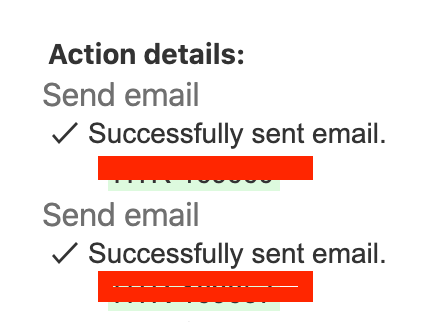

@Mark Segall  Thanks for your wonderful guidance. But here i am unsure it shows success few tickets but i didnt received mail so far. 09:18 Success but 09:28 No action it shows
Sampath
August 8, 2022
Hi @Mark Segall
Now it shows Success & schedule for tickets but email didnt received so far not sure in UAT authorized my mail id

below format i am using in send mail :
Subject : Response Required: {{issue.key}} - {{issue.summary}}
Content :
Hi {{assignee.displayName}}
A Quick Reminder that the ticket {{issue.key}} has passed one day. Please action your ticket as soon as possible.
Summary:
- Title : {{issue.summary}}
- Status: {{issue.status.name}}
- Url: {{issue.url}}
Thank You
XXXX
