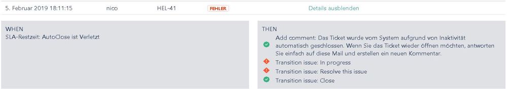

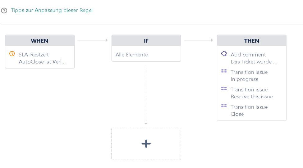

Hi, i created a SLA and a Automation, that if this SLA is breached, the issue get to be closed. But it wont.
As you can see in the error, the issue status could not be changed. i tried to get it from "Waiting for customer" at first "Waiting for Support" and then to "closed" but it also dont work.
I dont know why the transition could not be cahnged. Any idea?

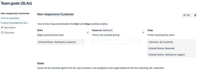

SLA:

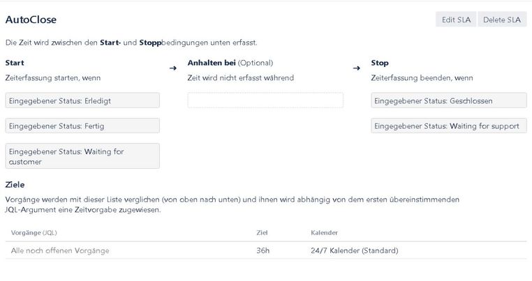

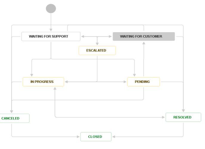

Maybe some can help me with this screenshots?
At Screenshot where "Closed" is background with color green (second image), the issue closed correcty, the other one not (first image)

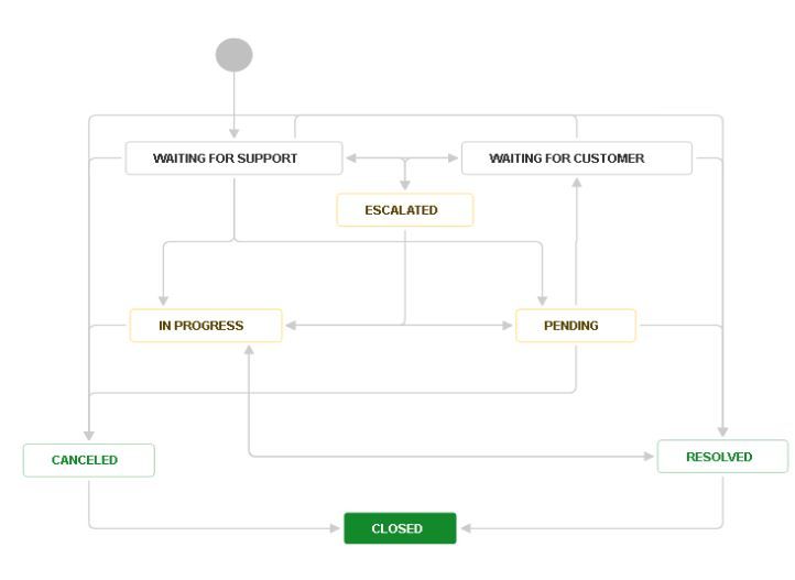

Maybe there is something why it could not be closed? must the issue be procces first and then closed or something like this?

I'm struggling navigating the German in the images but my first guess would be that the workflow doesn't support the transitions. the log seems to say it is failing to move to "in progress" and also to "Resolve this issue" but succeeds to "Close".

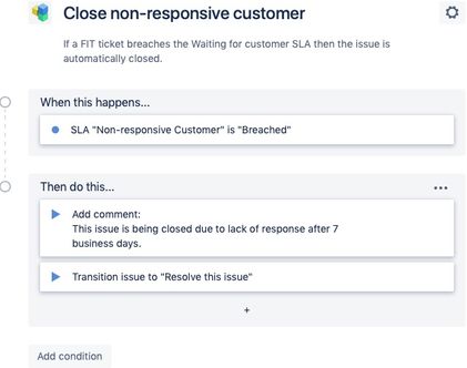

I'm on cloud and have a similar auto-close automation defined and it works great. here it is in case it helps. One possibility is that your automation is being executed by a user that does not have permission to transition this issue to closed. I would definitely check that.
SLA...
