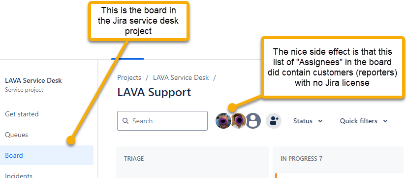

A nice side effect of assigning tickets to a customer (reporter) is that they show up on the Service Desk board under the list of assignees, making it easy to filter on a particular customer, to see what is in their "action" queue.

In addition, what board are you referring to in your nice side effect? I am assuming you are not referring the display in the Portal UI? Lastly, who is using the board?
"A nice side effect of assigning tickets to a customer (reporter) is that they show up on the Service Desk board under the list of assignees, making it easy to filter on a particular customer, to see what is in their "action" queue."

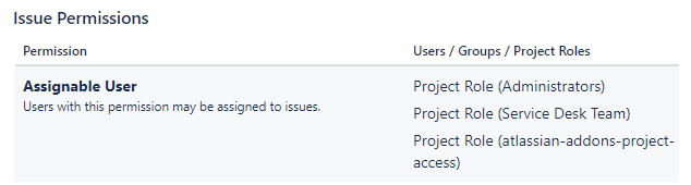

Can you also verify what is being called out in your project's permission configuration scheme under "Assignable users" permission?

The board is the display in the portal UI. Its the only board I am aware of that is associated with the service project. Our internal service desk agents use it (with Jira licenses):
When there were tickets assigned to reporters, they showed up in the list of assignees, so we could pick one or more of them to see which issues were on their plate. Worked very nicely (but have this assignment caused Customer Notifications to stop working).
This is our Assignable Users from the permission scheme:

PPS. If I added a Project Role (Service Desk Customers) to the Assignable User permission in our permission scheme would this allow the assignment to Service Desk Customers AND (most importantly) not cause Customer Notifications to fail? That would be a great solution for this issue, but I would want to limit this to the support project, as these users should not be assignable to tickets in our other Jira projects.
I tread very carefully in the permission scheme...
Thanks
Adding Service Desk Customers to your permission scheme for the specific project's Assignable User permission may work. You need to ensure that your Support project has its own custom permission scheme, so other projects are not impacted.
