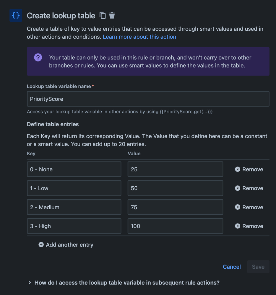

For the first part, this can be created with Create Variable and Lookup Table automation.
When: Issue Created
Then: Create Variable
Variable name: enter whatever you want to call it (i put 'OptionDescription' for this example)
Smart value: this would be the custom field, it doesn't need the 'issue.' {{customfield_field.value}}
Find smart value for custom field here
And: Create lookup table

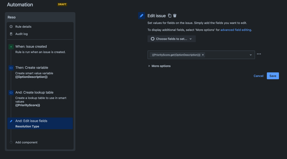

And: Edit issue fields
Select your custom field
add smart value: {{PriorityScore.get(OptionDescription)}}

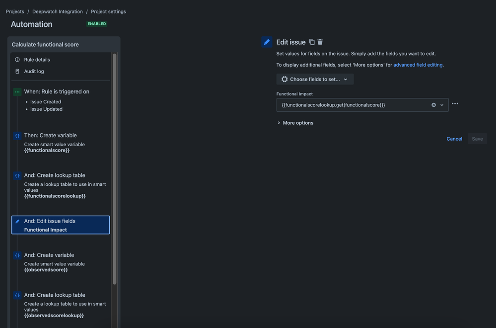

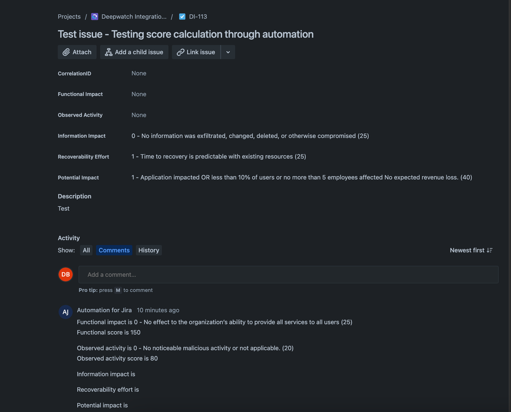

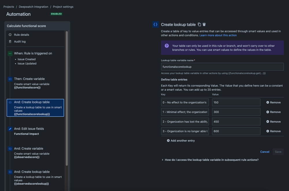

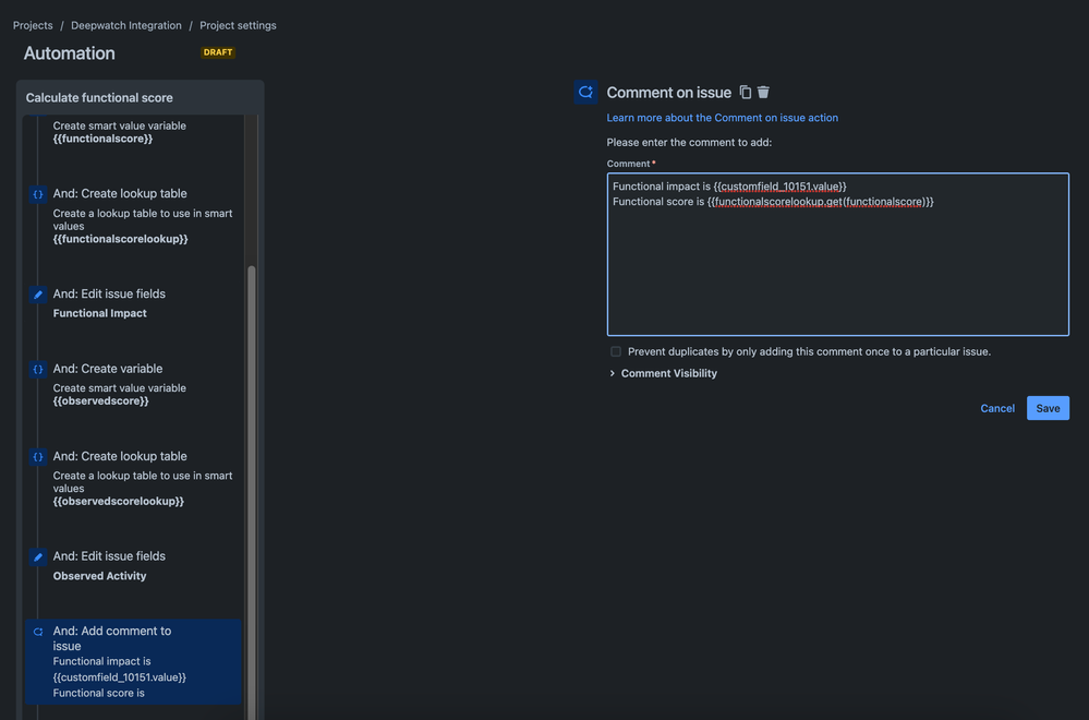

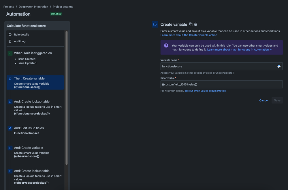

Thank you for the solution! The issue is working as described but the original values for the custom field are reverting to "None" after evaluation? I would assume this is something I missed, but here are the screen shots for the current configuration:
Here is the "create variable" automation:
Create lookup table:
Edit issue:
Edit comment to verify results (working):
The custom fields reset to "None" even though the customfield.value and smart values are listed correctly in the comments:
Any ideas or suggestions in how to keep the values for the customfield?
Riley Sullivan
June 29, 2023
@David Bristol
Can you lookup the type of field your custom field is? Text? Numeric?
Also, when you go into the audit log of this automation, does say it edited the field? It should say Issues edited successfully twice for the screenshot you provided.
One other idea to try, is to just try one lookup table per automation. Lookup tables is a newer feature, and I am pretty sure in the release article they mentioned that having multiple lookup tables might mess things up or not work. Maybe give that a try as well?
