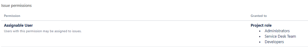

I have set the Developer role to also be assignable which does not work:
So currently the group which has the Developer role can only add internal comments (which is fine) but cannot be assigned (which is a problem.
