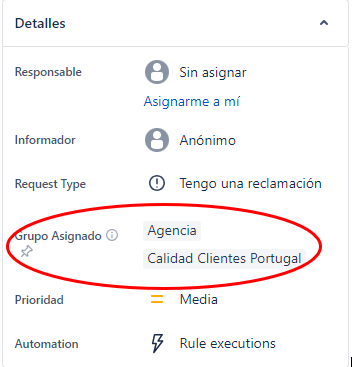

Hi @Trudy P Claspill , both "organization" and "reviewer" are group of users, which I assign to the tickets in the "Assignment group" field.

Hi @Trudy P Claspill I add both the organisation and the reviewer to the assigned group.
My problem is that with the security scheme I have, the ticket can't be viewed by both groups at the same time, as the security levels are different.
I would like the assigned groups to only see the tickets that they have assigned to them. And have more than 1 group assigned to each ticket.

I believe what you need to do is change your Security Level definitions. Instead of having two levels with each one designating a Group, have one level that uses the Group custom field value option, and select the custom field you indicated - Grupo Aignado.
I believe that in that case with that level assigned to the issue then anybody assigned to any group specified in that field would then have access to the issue.

@Trudy P ClaspillThank you so much!!!, it works just as we wanted it to, you don't know how much we appreciate it!!!
