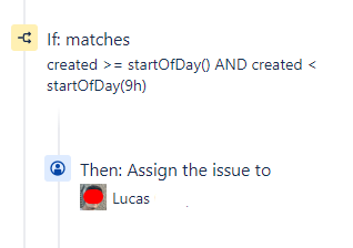

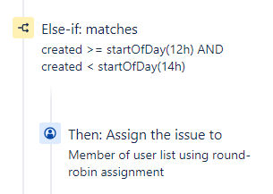

But now I'm using JQL and created date to assign issues.
For example, I know some issues are opened between 00:00 and 9:00, but I have just one person working at 8:00 till 9:00, so, all issues opened after midnight and before nine o'clock are assigned to him.
created >= startOfDay() AND created < startOfDay(9h)
And after 9h, I have more staff working, so I can distribute for more than just Lucas

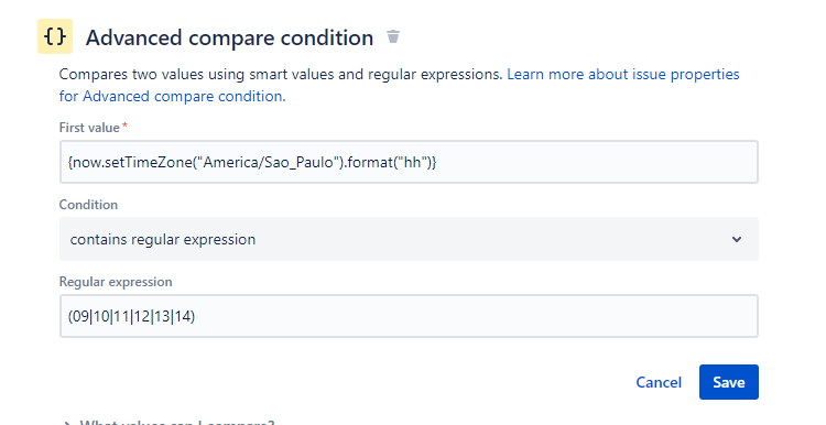

You also can use Advanced Compare Condition using {now.setTimeZone("America/Sao_Paulo").format("hh")} and use regex to validate if the hour is present, like this:
So even if the trigger is "when created" the automation will only assign issues if it runs between 9 and 15.
