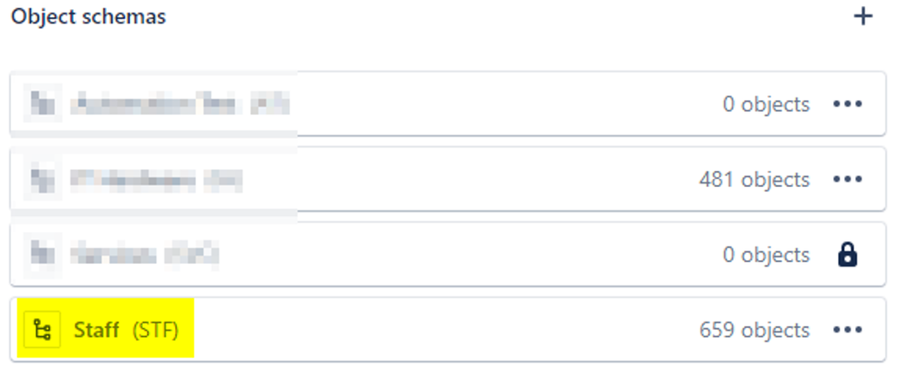

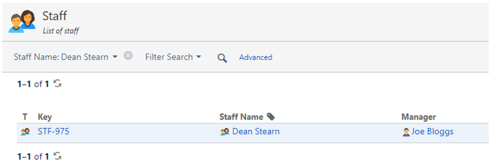

Hi, our company is now investing time on the Assets module and I have been busy building Object Schemas / Object Types etc.
I have now got to the point where I am trying pull through a value from Assets to display on my Issue Ticket, and this is where I am getting stuck / confused....
This is what I have: (see attached screenshots)
Object Schema
  • Staff
Object Types
  • Staff
  • Managers

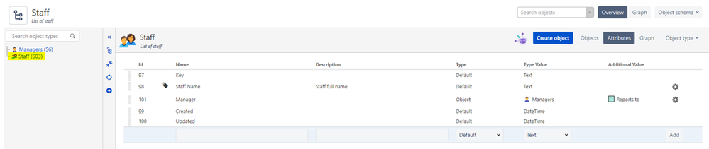

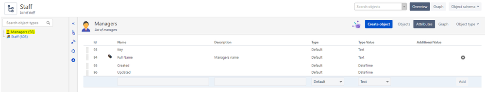

Object Attributes
  • Staff
  • Managers
What I am trying to achieve is for the 'Manager' name to be pulled through to the ticket based on the name of the Reporter that raised the ticket.
For Example:
I raised the ticket so I am the reporter - Dean Stearn
In the Staff list, Dean Stearn has a manager named Joe Bloggs, so I want a field on the ticket for Manager to be visible that shows Joe Bloggs.

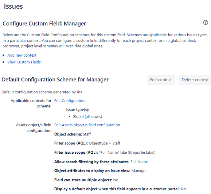

I have created a custom field (Assets Object field) that appears on my ticket.

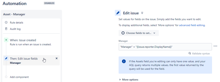

I believe an automation rule is also required, so I have set one up that triggers when any issue is created.
This is how far I am getting and not getting the results as I expect.

Hi @Dean Stearn ,
What are the results that you are seeing?

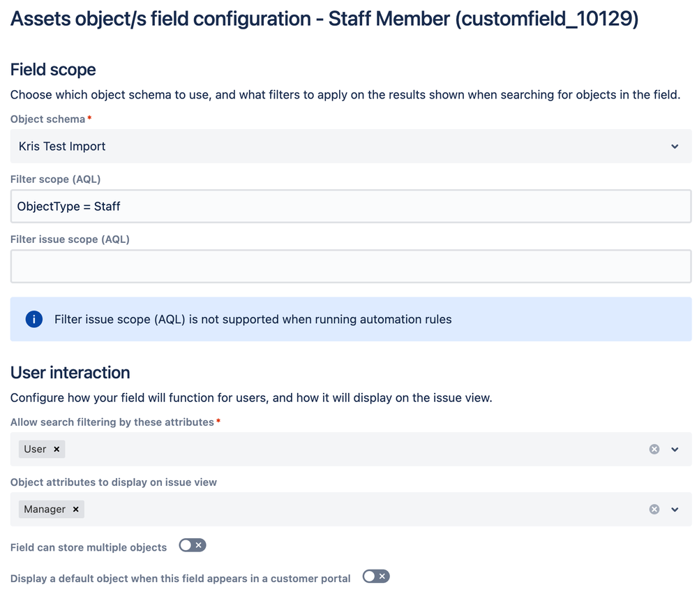

First of all, I see some strange things in your configuration. You have a custom field "Manager" that displays information from the 'Staff' object type (Filter scope AQL).
Instead of using "Full Name" for both "Manager" and "Staff" (Default text field), I would use the attribute type "User" to link directly to a user account.

Hi @Kris Dewachter ,
At first, the reporter name was pulled through and then if I expanded the asset object it would then show the manager name.
I thought this was sort of correct, but when I updated another staff member to have the same manager as me, when I created a new ticket, their name was pulled through instead of mine as I was the reporter.
My rationale for using the "Staff" object type for the filter scope AQL, is because the manager's name is displayed as an attribute on the "Staff" object type. This is where I am getting myself confused as I am not sure if the filter scope should be "Managers" instead.
Your suggestion about using the attribute type "User" instead of "Default", I don't follow what this does. When  I change the Type from Default to User, I then have to select something for Type Value. I was expecting to see a list of users, but instead I see User Groups.
Should I just select a user group for the Type Value?

But I also want to go back to your initial setup.
  • Why do you have a separate object for "Staff" and "Managers" ?
  • Is a Manager also not a Staff member?
  • I presume most managers also have a manager of their own. How will that be handled ?
Maybe it would be architecturally better to have only 1 object type "Staff" that contains both. For managers, you could have an optional attribute "IsManager" that could be yes or no. And in the "Staff" object, you can have an attribute "Manager" that just links to the same "Staff" object. In this setup, you would no longer need a "Manager" custom field, as you would see the manager from the user details in the ticket. Just a thought.

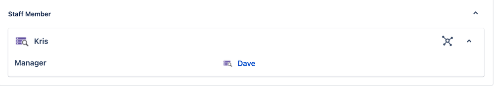

The only part that I am not getting is your last statement.
I raised a ticket in my name, however I don't see anything relating to user details, other than the name of the reporter.
Apologies, but can you provide a screenshot of where you are seeing user details on a ticket, for the life of me, I am not seeing anything.

Hi @Dean Stearn ,
You will still have to link the "Issue" with the Asset Object via a Custom Field.
You can create a Custom Field "Staff" that pulls the data from the Assets.
To populate the field, you can make it visible on the screen, or automatically fill it with an automation rule (probably the best solution).
When the field is populated, when you select the "Manager" attribute in the "Object attributes to display on issue view", you will see it on the issue detail screen when you open the details of the "Staff Member" details field.

Thank you @Kris Dewachter ,
I have now created a custom field and an automation rule and the details are pulling through as I would expect.
With a bit more experimentation, I hope to become more familiar with how it all works and start pulling some more useful information through to our issue view.
