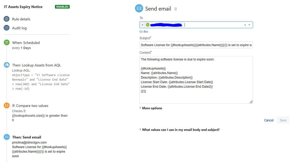

I have assets that have a License End Date attribute. I have setup automation to send emails when they are about to expire. What is sent in the email is the following:
Description: `Knowbe4 Security Awareness training
License Start Date: 1712016000000
License End Date: 1743566400000
The dates are in the wrong format even though they show correctly in Assets:
Here what my automation looks like:
I have tried different smart values formatting like {{attributes.License End Date2.jiraDate}} or
 {{attributes.License End Date2.format("mm/dd/yyyy")}} and nothing seems to work.

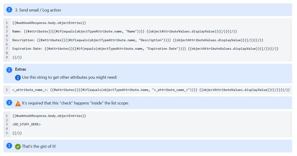

This is what worked for me after consulting with Atlassian support:
I had to create a personal authentication token and then use that in the automation rule:
Let me know if you need more info.

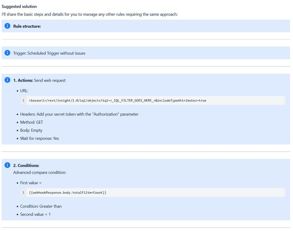

Hi @Trudy P Claspill I unmarked the answer as unaccepted. I had to talk to Atlassian support in order to get it to work correctly. We ended up using /rest api in order to get the data and then convert it from there. If you need those steps let me know and I can add them here.

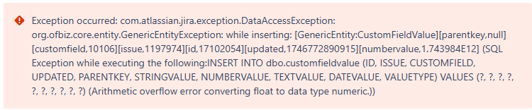

I also looked at stuffing the value into a Number field (Story Points) in the issue, but in my case that cannot be done because it caused an error in the database trying to convert a Float to a Numeric.

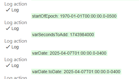

Subsequently I found that this worked instead:
{{now.toStartOfDay.withYear(1970).withDayOfYear(1)}}
Otherwise I tested your solution and it appears to work!! I'm going to do more testing to make sure.
