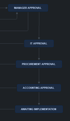

Totally get the portal view and not being able to see sub-tasks. Said tasks are for the Service team specifically so the customer does not need to see them. However, they do need to be completed before the issue moves to the next step.
Here's the portion of the workflow in question:
Automation rules are currently creating the sub-tasks when the issue moves from Manager Approval to IT Approval. There is a condition on the IT Approval -> Procurement Approval transition where said sub-tasks are supposed to be checked to be 'Done'. However, this is not being honored when the Approve button is clicked by an IT approver. (IT members responsible for the sub-tasks are also the approvers so they can see them.)
My concern more generally as I start to implement other approvals is that if I add any other conditions, say field requirements (yes, could be done with validators, just an example), is that they will not be honored when the Approve button is clicked,
