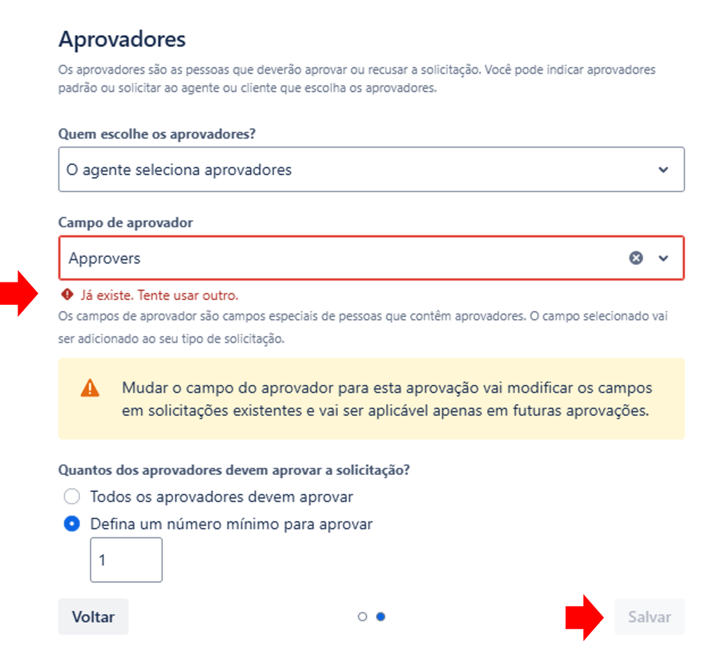

I had also tried this option, but notice in the screen below that I get an error message, saying that this field already exists and that I have to try another one. Also notice that the Save button ("Salvar") is not available to click, when I set the field to "Approvers".

Mathew Lederman
March 12, 2025
Is it possible you're using the same field in a different place in the workflow?
