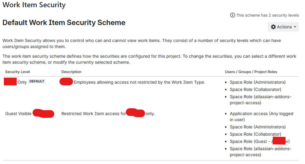

I've set up a Work Item Security Scheme with two Security Levels. One for my org's employees and another for Guest Vendors which I've assigned the guest space role to.

I can confirm Work Item Security works very nicely with guest users. I just needed to give the guest user "Guest - Collaborator" space role as well as the vendor specific one.

Can you show us the Security Level configurations in the Security Scheme you associated with the project?

Yes, I've set the security level on all the work items in the space with some of them having the guest visible security level.
Have you added the guest users to a custom role or to the native "Guest - Collaborator" role? Based on this document, I believe you have to add them specifically to the Guest - Collaborator role in order to give them Guest access to the Space.
https://support.atlassian.com/jira-cloud-administration/docs/manage-guest-access-in-jira/
I suspect that adding them to a custom role does not actually give them access to the space, but if you add them both to the native role and to the custom role that might work.
