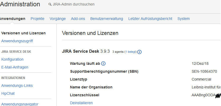

Hi Alexey
The licenses should be fine, and they were bought three weeks ago.
There is only one account in use. The license includes three accounts.
