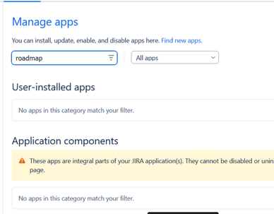

Advanced Roadmaps does not show up under Manage apps -> Application components
Lucas Theisen
May 5, 2025
This KB article indicates that i should be able to see the Advanced Roadmaps for Jira app under the Application components section of Manage Apps after setting the dropdown to All apps.  However, I do not see it there:
I have noticed this sequence in my log file:
    2025-05-05 06:23:02,596+0000 Caesium-1-4 INFO ServiceRunner     [c.a.j.migration.fx3.Fx3PluginClientImpl] Remote state: Fx3State(cloudId=dummy-cloud, fx3FetchTime=1745435334040, customAttributes={}, payload=)
    2025-05-05 06:23:02,611+0000 Caesium-1-4 WARN ServiceRunner     [c.a.p.i.querydsl.schema.DefaultSchemaProvider] Could not find the physical database object for the logically named 'ROLE_TYPE' aka 'column:PROJECT.ROLE_TYPE'. Is this expected database state?
    2025-05-05 06:23:02,671+0000 Caesium-1-4 WARN ServiceRunner     [c.a.j.migration.version.VersionService] Plugin version could not be determined for plugin with key com.radiantminds.roadmaps-jira. Reason=Plugin accessor failed to find plugin with key com.radiantminds.roadmaps-jira.
    2025-05-05 06:23:02,692+0000 Caesium-1-4 ERROR ServiceRunner     [c.a.scheduler.core.JobLauncher] Scheduled job with ID 'jira-migration-analytics-server-analysis-job-id' failed
com.querydsl.core.QueryException: Caught PSQLException for select count(*) from "public"."AO_D9132D_DEP_ISSUE_LINK_TYPES" "AO_D9132D_DEP_ISSUE_LINK_TYPES"
Which seems relevant, but it is unclear how to proceed...  Any suggestions to help figure out what is preventing me from seeing the Advanced Roadmaps?

@Lucas Theisen
Welcome to the community.  In your DC env, did you upgrade to your DC env based from a Server env?
Please advise.  So we can assist you further.
Best, Joseph Chung Yin

Yes, we did upgrade from Server to Data Center a while back.
SERVER
VERSION
10.3.5
